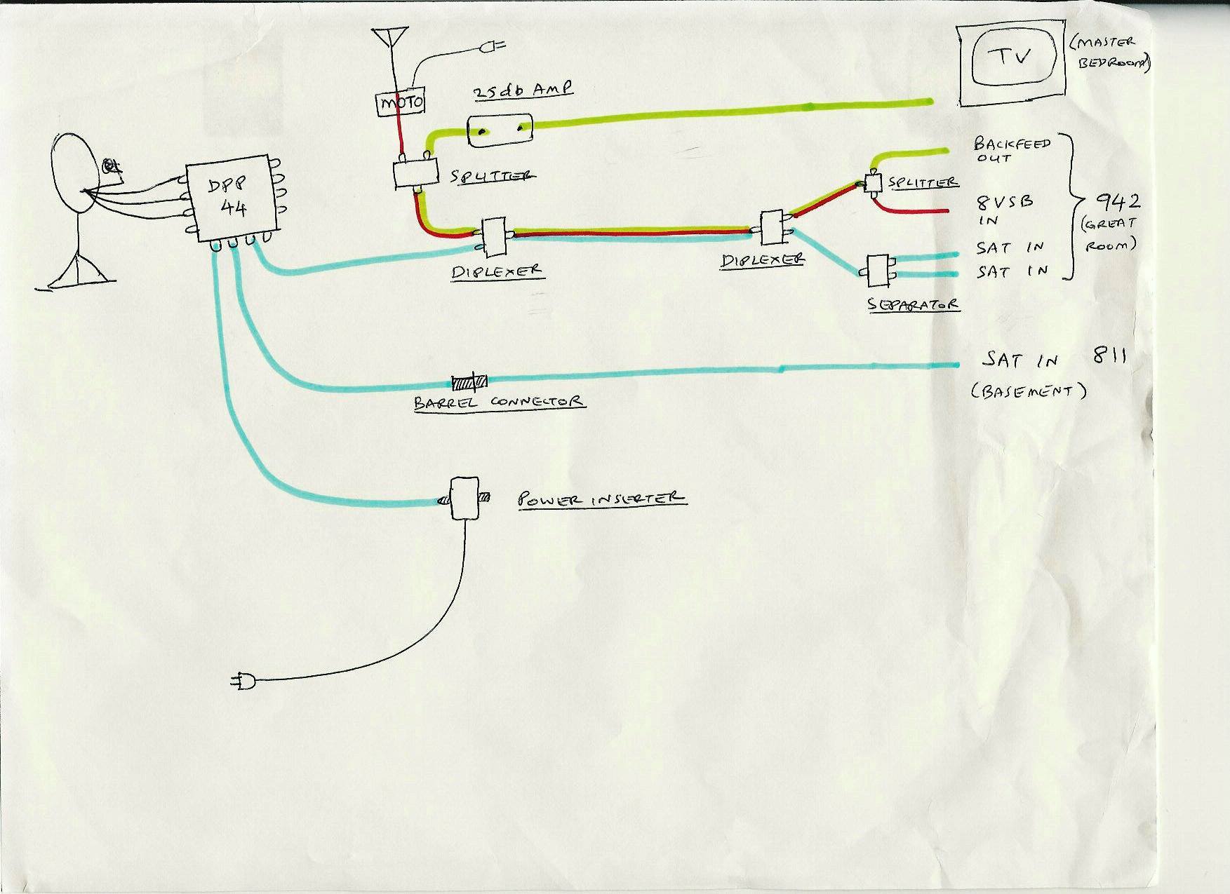

I have my satellite feeds, OTA and the backfeed from the 622 all on one coax cable with the use of diplexers and a separator. See attached diagram..(this was drawn a couple of years ago - since then the 942 has been replaced by the 622, the 811 by the 211 and the DPP44/Superdish combo with a Dish 1000.2)
personally, i would combine the satellite feeds and the OTA, and run a standalone cable for the cable company stuff. That way you don't have to worry about any problems with the internet quality... and no interference backfeeding the TV2 side out of the receivers.
Just my opinion
Exactly!
The moment you start sending TV2 backfeeds back up the cable company line, you're opening up a big can of worms. Theoretically, a neighbor that is subscribed to cable could view your TV2 signal. Not to mention a lot cable internet systems don't operate properly when diplexed with a satellite signal.
