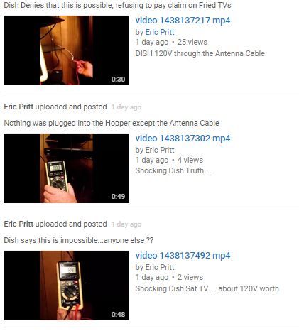

Watched his other videos posted on YouTube. He clearly thinks this is Dish's fault. Also in 1 of them the hopper was unplugged from the receptacle. Voltage is being introduced into the coax via ground without a doubt.
He's got a serious situation that needs addressed immediately. The 1 thing that blew me away is when he let a young girl hold the metal end of the voltage tester while he touched the hot lead to the cable. She was getting shocked.....this is not how you test for voltage with a human ground!!!!

This isn't an issue with Dish hardware, this is clearly an electrical wiring issue within the structure of your house. If you have multiple receivers/hoppers/joeys, the coax connects multiple circuits together at the grounding block, LNB and node. In a house that the wiring is correct on, this isn't an issue. If you have a receptacle along the way that is reversed, it can create an issue. The wood paneling in the picture is almost always a sign that someone did it themselves, and did it wrong.
