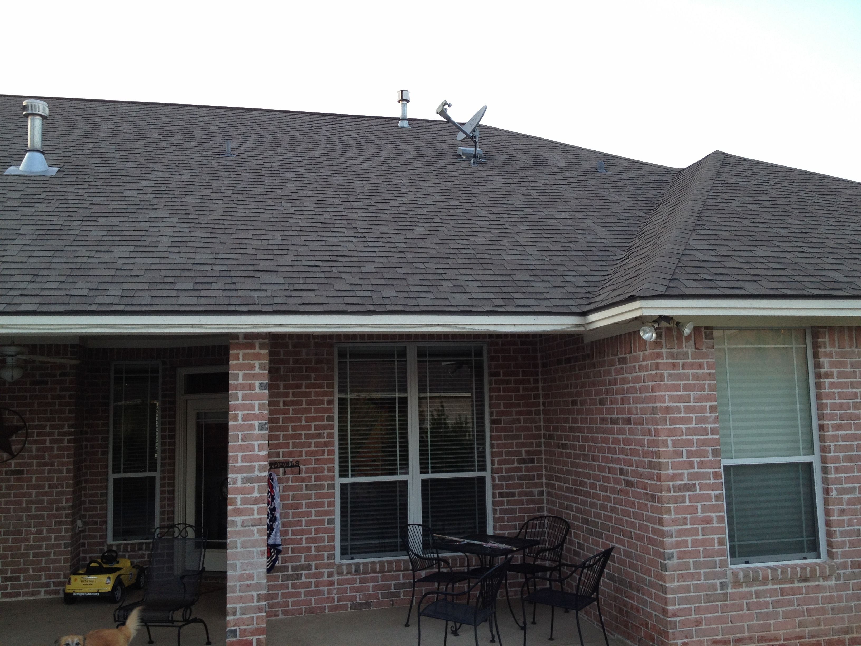

I am looking to upgrade to Hopper soon which means a tech visit but I have an old issue with my Dish not being grounded and I am wondering if I need to have it addressed during the upgrade. The last time a tech came out to work on my Dish he said my Dish was not grounded. The tech said whoever installed it originally did not do it correctly because it wasn't grounded. The tech seemed frazzled about the situation and was pacing back and forth wondering "what am I going to do"? This tech was only here to run an additional line from the dish because I was adding a reciever. He finally just ran the line but he then wrote on my paper work "dish not grounded" before I signed it.

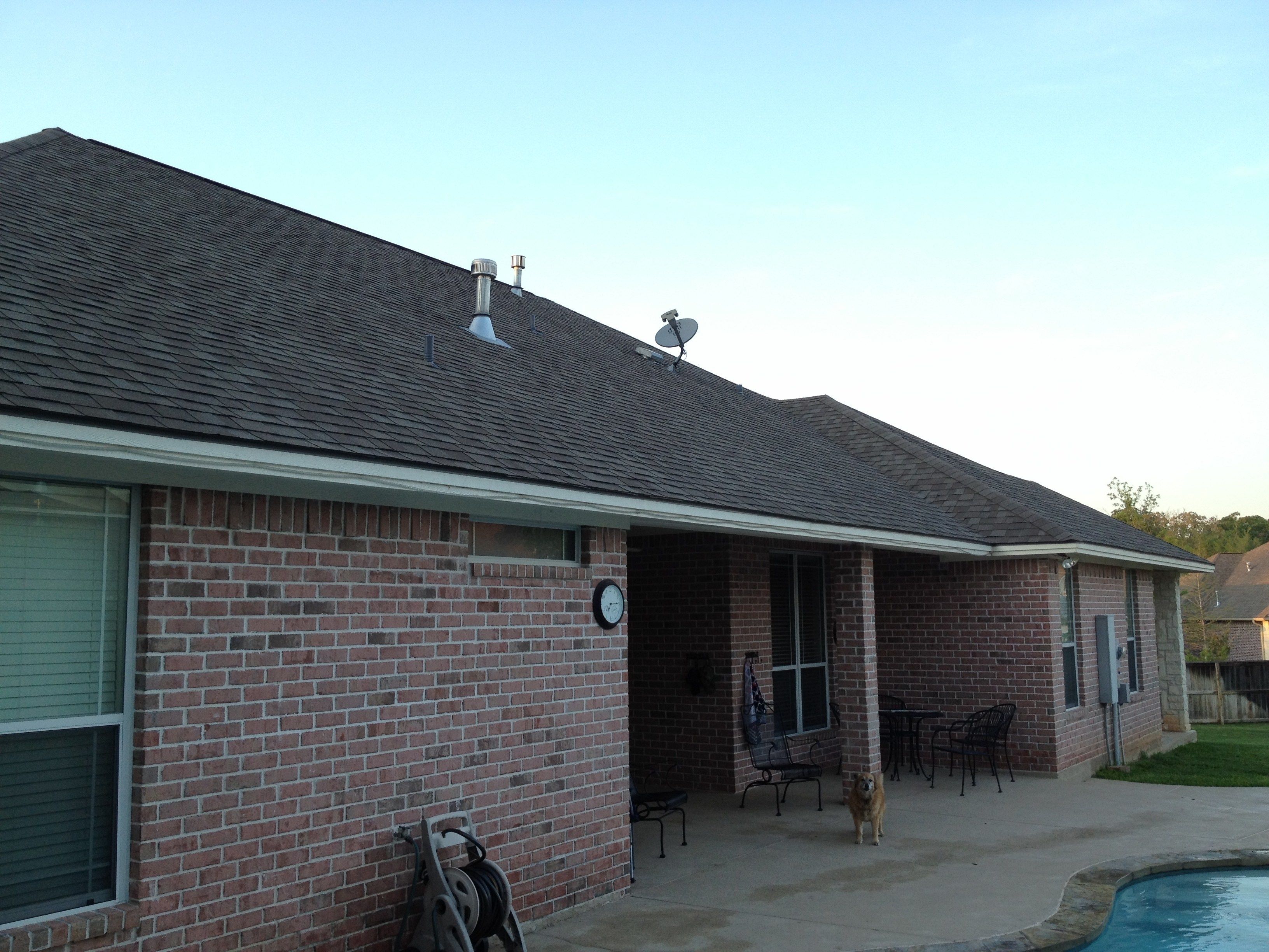

From what I can tell it is not grounded. The dish is near an exhaust vent on the roof which is about half way up my roof. The tech just ran the wires down through my attic by the exhaust vent. The wires then enter a wall by my laundry where I have a distribution panel. From what I call tell, there is no ground wire running from the Dish.

This part confused me, what do you mean? I do not have any type of ground block on the exterior of my house except for the one used by the cable company (I have cable internet). The cable wires from my dish enter my roof right next to the exhaust vent. The wires do NOT run down my roof to the exterior of my house and enter there. My dish is installed probably 20 feet up my roof.
Sounds like u need to have that dish taken down and a new hd dish mounted in a more accessible location, over an eve or on yyour facia or a sofit mount. What u decribe is not up to dns standards. U should request an inhouse dish tech to do your upgrade and he will follow all the qas guidelines. Including installing a ground block etc... Btw a ground block is a metal component about three inches long and has two barrells in the middle.
It sounds like you have an old installation. Guys used to just mount the dish near the top of the roof and feed the cables into the attic thru a roof vent so they don't have to make anymore holes. This is not Dish approved anymore. OSHA requirements state that anytime we walk on a roof we have to install a roof anchor on your house and tether ourselves off with a fall protection harness that is only 10' long. Current Dish guidelines also only allow us to mount the Dish on the part of the roof that is an overhang (at the edge of the roof) so that in a worst-case scenario of a leak it is not over a living space inside your house. Don't be surprised if all of this is brought up when you upgrade.
If I came to your job I would tell you I had to mount a new dish at the edge of your roof. Run the cables to a GB on the underside of the eave, and then I'd run them into the attic through that same eave and tie into the existing cables. If your old dish is more than 10' from the edge of the roof I would be unable to take it down. Ideally I would mount the dish near your power meter so that I could ground to your house ground wire or meter panel. An A/C disconnect box can also be used as a ground source (not ideal though).

Here are a couple of photos showing where my Dish is installed.
