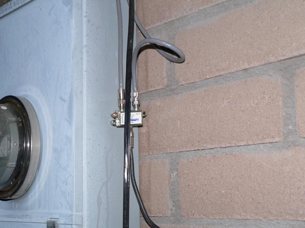

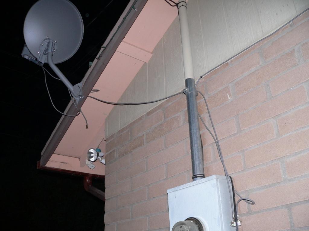

They need to head down to Nogales, AZ. Here's a couple of pics from my aunt's house. No ground. Wires hang from the dish. No drip loops. No compression nut on one of the cables. I called Dish for her and she said to call the installer. The installer said it's working so they'll do nothing. We get many lightening storms during monsoon season. I sent these pictures to CEO@echostar.com and got no response.
Another aunt had an install with no ground. They also ran the second tv from the 522 across the floor, along a step then further across the floor to the kitchen TV. They used clear plastic tape to hold it in place.
