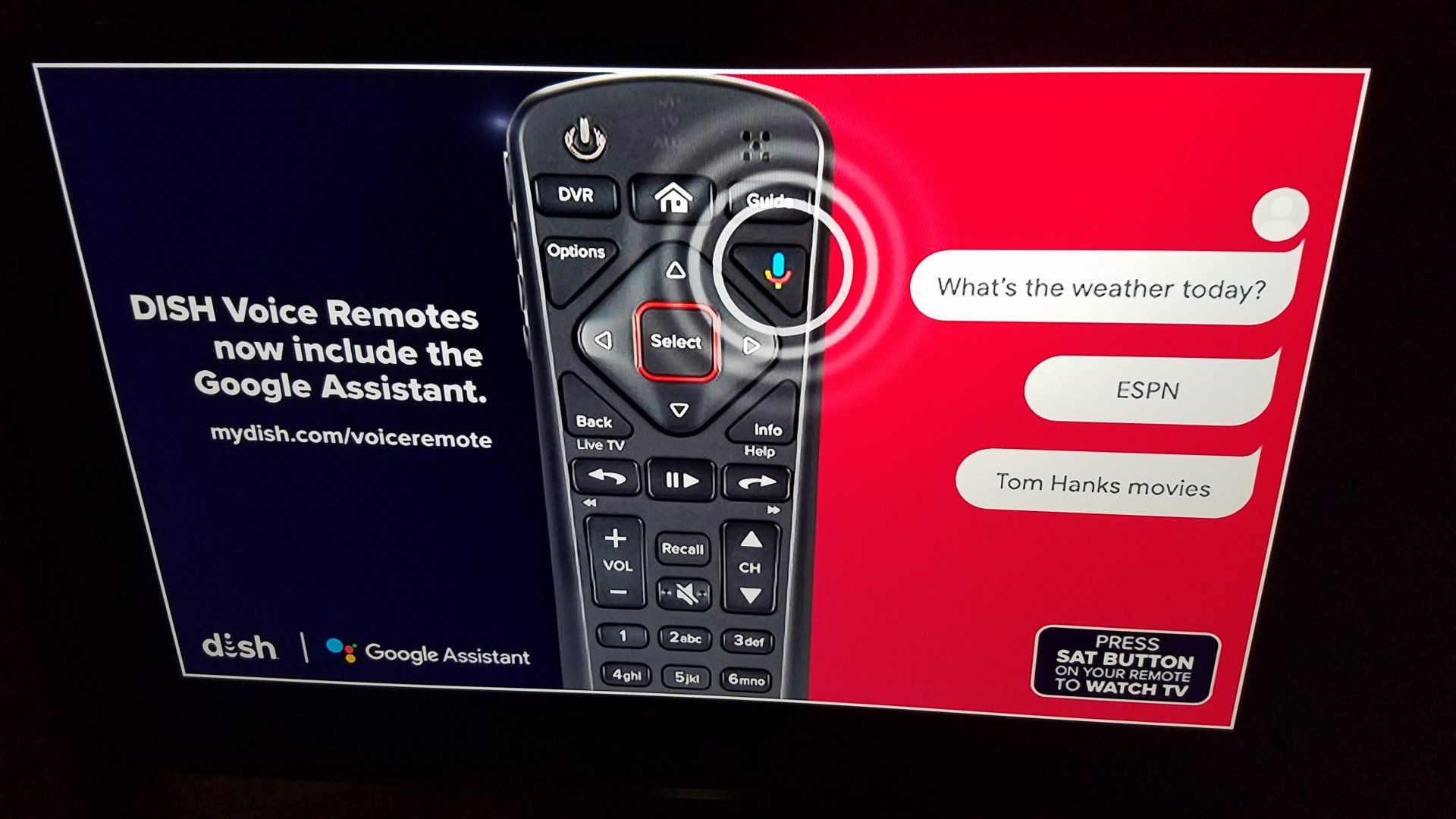

I'm getting an increasing number of annoying pop-ups on my Hopper 3, during DVR playback and live broadcasts. The screen goes blank for second, then the unwanted ads begin. Of course the dialog is in mid-sentence when it happens, so it's hard to get back to where I was before being so rudely interrupted.

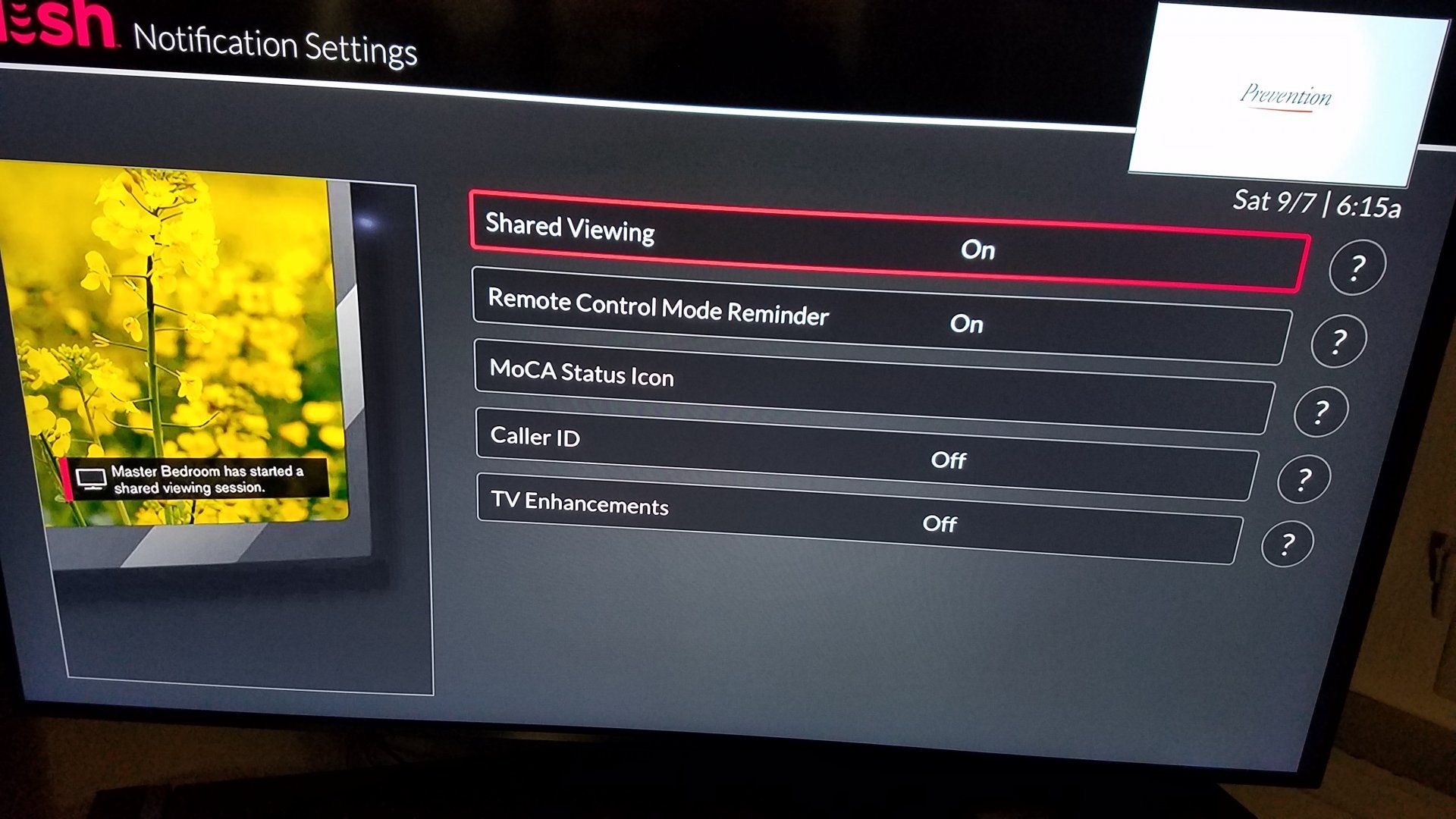

Do you currently have the TV enhancements feature on? You can check this by going to the Menu > Settings > Notifications > TV Enhancements. -Jasmine D.

That description sure sounds like the standby screen saver.
From your description it isn't ads and isn't a pop up - DISH does not do pop ups during programming. (The closet to that is generated from the channel itself in conjunction with DISH when it says to watch this or that program now, hit the remote button). They do not put ads over live programming unless it is during a time there would be a commercial anyway. In fact I bet they are prohibited from doing so even if they wanted to. It sounds like it is the inactivity timer kicking in, and what you are seeing is the screen saver that bounces to avoid burn in, and that contains information from DISH.

If you have a way to take a picture of the screen with the pop up it could be helpful.
What's wrong with the attachment in the OP?
Actually nothing! I missed it. :( That is definitely a standby screen. The receiver is being told to go into standby. It is either a remote signal or an inactivity timer setting. I know the OP said he would check that when he got home. He should disable it. I have disabled that setting for all the years it's been available.

Hey there, jpmarto. From everything you describe it sounds like 3 different things are happening. The screen shot you provided looks like the Standby Screen, and increasing the Inactivity Timeout will definitely help with that. By default your screen should swap to the Standby Screen, if you don't use your remote for over 4 hours.
The second pop-up sounds like there could be some sort of timer conflict or something of that nature. You will receive a pop-up on your screen when all your timers are in use, and a recording is scheduled to record. This message will ask you if you would like to join another session in progress, join what's scheduled to record, or watch something on your DVR. Does this sound like the message that you've been seeing? Do you normally notice this particular error message at a certain time?
The last pop-up sounds like the nightly update. By default this occurs around 2:00am at night. If you are often seeing this message, we do recommend setting the nightly update to a time you are not using your services. You can find this in the same place that would change the Inactivity Timeout, in the Power Settings. - Caleb S
Caleb: the nightly update I understood, but was suprised it came on at 2:30am, when the preference was 2am. As for a timer conflict, my Hopper3 has 16 tuners, and I doubt we've ever had more than 3 simultaneous timers.
So, in summary, what I'm seeing is the standby screen. I've gone from the original Hopper, to Hopper2, to my Hopper3 and have never before experienced this. I've set my inactivity timer from 4 hours to 8 hours so we'lll see if that helps.
