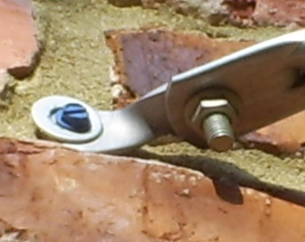

No I haven't, but then again, the holes on the dish mounting plate are much to small for the tapcons, and thus the installers end up using crappy washers. Yeah, I suppose that makes a good mounting choice, especially when they are in the mortar joints. You can quote your specs all day and night. The fact is, the heads on those things are too small for this application, and most dirtbags are installing them wrong on top of that. Specs don't mean jack if the product isn't properly installed. I'll take a lag shield/screw combo in the brick anyday over this type of junk:
Blame the skill and his ability to choose the correct materials and methods. The Tapcon should NEVER be installed in the mortar joint, and the washer needs to match the diameter of the screw.
