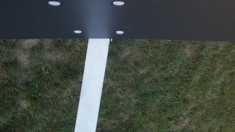

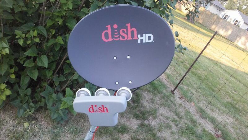

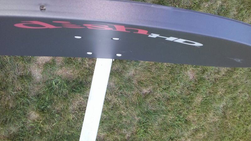

Looking at the dish from the front the arm the arm goes out to the left?

Had my dish moved because of trees and now my HD changes to SD any time it rains?
The signals vary from transponder to transponder so unless you specify what transponder the readings you're posting came from it's impossible to accurately compare.
You're in Ohio, using the Check Switch Screen on your receiver, Transponder 21 on all three sats, you want to see the 110 and 119 in the 70's and the 129 in the mid to high 50's, and yes, your feed arm looks bent
