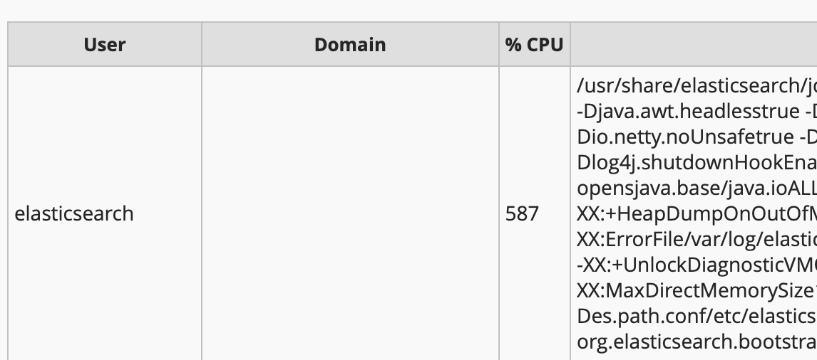

Looking at things it appears the ElasticSearch (which is our search engine) detected data corruption and did a full reindex. Cpanel shows it was using 587% of the CPU to do it.
I am guessing it finished before I got home.
Everything else is working as normal.

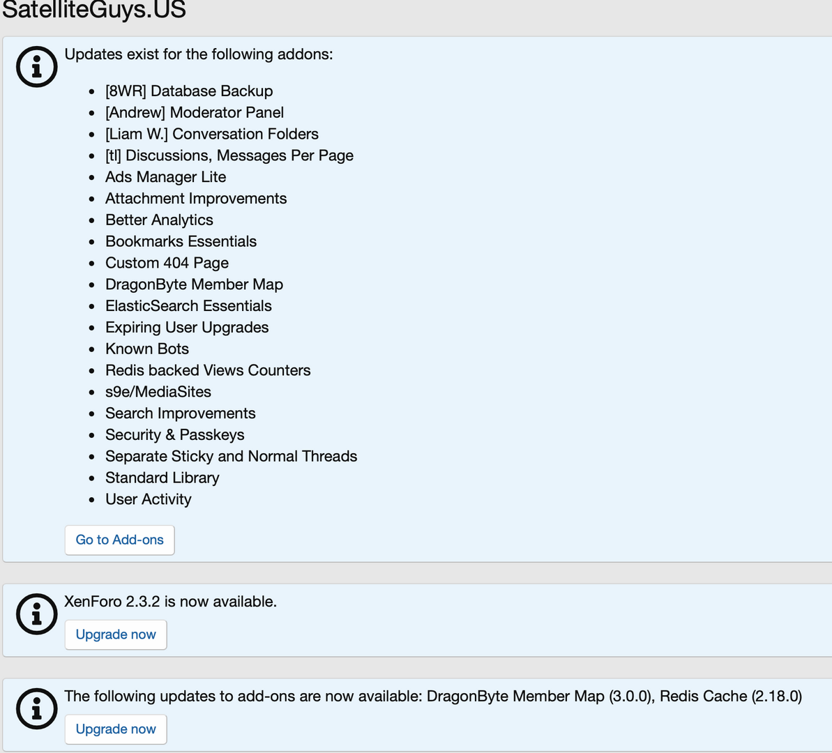

I am fearful that this could be related to us not upgrading to Xenforo 2.3 yet. There are some backend things that automatically update themselves as part of daily maintenance and some of these updates may be intended for the newer version.
I am going to have to bite the bullet and sit down and upgrade the site which I am scared to do as I know some of our older plugins will not work as there are some major changes between 2.2 and 2.3. Remember a few of these plugins were written for us a few years ago. The authors who wrote them for us are long gone so there are no updates available for some of them.
Most people who have upgraded through have not reported any issues... If you remember I tried making a clone of the site and upgrading that and it actually crashed the live site. Crashed it so bad we lost a few hours of posts. Days later after Xenforo support looked into things they report the issue was caused by our intense caching. (I believe that made some changes in 2.3.1 to prevent that issue for others and now 2.3.2 is out with a bunch more fixes.)
Here is a list of updates available that I can not do until I update to 2.3.
I will try to make some time to do it, possibly next Sunday. I will have to take the site offline do another backup for safety then do the upgrade.
