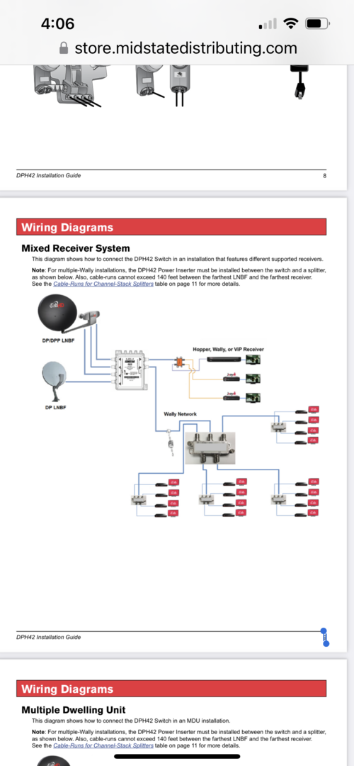

Hello I have almost everything wired but have a question. I have 1 hopper 3 and 1 wally.
Coming from a dpp ea.2 LNB, port 1 to port 1 on switch to Hybrid solo hub to hopper 3.
Port 2 of LNB to port 2 on switch then pit to power inserted then to wally. Everything I see is multiple Wally's and have a splitter after power inserter. I belief I do not need any splitter with just 1 wally.
Thanks in advance.
I want this with only 1 wally.

It is as you say, you can ignore the splitter and just connect the Wally to the receiver output of the power inserter.
Thanks everything worked perfectly. Just need to try to adjust signal on 72 alittle more getting just 39 but getting 60 on 62.5. Not sure if it's skew or azimuth. But will try tweaking.
