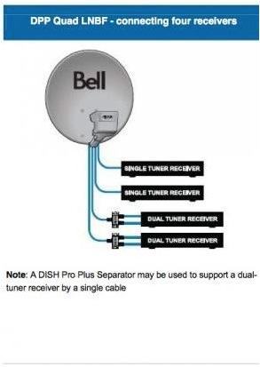

Just thinking out loud here, but is it possible to:
connect 8 Single-Tuner receivers on only 110 & 119, using just a DPP Quad and 4 DPP separators?
I was unsure whether you can use one DPP separator for every 2 Single Tuner receivers. (I only see the DPP separator mentioned for the Dual-Tuners.)
Thanks for any input :)
The DPP separator allows two tuner receivers to feed both tuners using one coax. It cannot be used to split the signal to two tuner on separate receivers. There is no reason to use one when feeding a single tuner receiver.

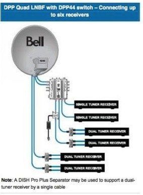

I'm referring to the DPP Quad, as demonstrated in the image below (Bell TV in Canada uses the same equipment). The DPP Quad does exist. Now the image below shows only the Dual-Tuners using the separators. I'm wondering if two Single-Tuners can replace each of those Dual-Tuners in the image below.
And an SW34 switch just wouldn't make sense in a DP setup. (Nor have I heard of one).
Thanks for your inputs!

What do you think of 6 Single-Tuners fed from a DPP Quad (outputting 2 of the 4 DPP Quad feeds) and a DP34 (using 2 of the 4 DPP Quad feeds, outputting an additional 4 feeds). See the image below, where the DP34 would replace the more costly and power-needing DPP44:

There is no way to use a separator for two separate single-tuner receivers as there is no way to have inter-receiver communication in order for them to properly utilize band stacking.
So it sounds like 8 Single-Tuners fed directly from a DPP Quad and 4 DPP Separators does not work? Has anyone directly attempted this?
it wont work. Folks have tried it with the DishProPlus Twin which is basically the same thing sans only 2 outputs. The separator only works with dual tuner units
use a DPP33 and you'll be fine. I dont think a DP34 will work.
