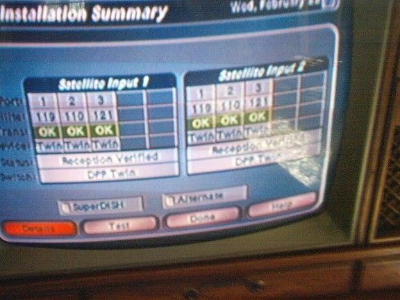

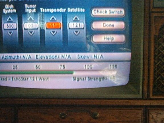

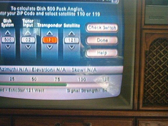

Alright!! Update to my question. Answered my own.
It really DOES work!!! No difference in signal strength...channels come in fine...etc...blah....and blah!!
As stated earlier, our RSP has been given major amounts of grief trying to modify workorders to a DPP44 switch. And even when sucessful, Dish has gone out of their way to not reimburse them. Not sure why. Its all in the notes AND the workorder reflects such an upgrade in switch. Oh well...point is, this tidbit can be added to whatever other types of random and possibly useless trivia out there.
