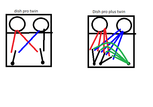

DishPro equipment doesn't band stack. it switches. See poorly drawn diagram. What I'm trying to say is that on DishPro equipment is that depending on the signal from the receiver it just switches witch sat it is looking at. It doesn't look at all the sats all time, if it did you'd end up with basically the same thing as direct's swm module.

I think when I say band stacked I mean something different than when you say it. When I say it I mean that there are two separate satellite signals layered one on top of the other. And I Know DishPro equipment has only one sat signal per cable. What do you mean when you say band stacked?

bandstacked is when the "normal" horizontal polarity channels are "stacked" above the vertical and made vertical
so as example....the old Superdishes that had a KU Band LNB and 2 DBS
"normal" KU is 11700-12200 frequency
"bandstacked" is 11700-12900.
Verticals are 11700-12200 and horizontals are now 12400-12900 and made vertical
brother anole also lists it out pretty well
http://www.satelliteguys.us/2127115-post5.html
All Dishpro LNB"s are bandstacked
