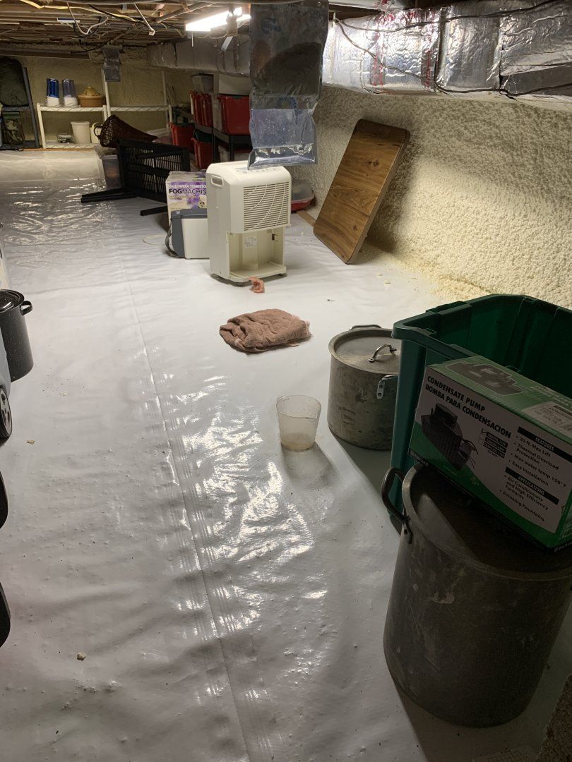

HVAC humidifier in winter, dehumidifiers in enclosed crawl space in summer. We paid big bucks to clear out mold and mildew, seal walls and vents to outside and French drain the sodden soil next to the house at one end. Also put in covering all over crawl space floor and walls (with foam insulation) and installed two HVAC vents to make it semi habitable. And must keep humidity low to prevent recurrence.
