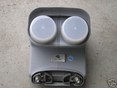

    Sounds like you need a Dish Pro dual LNB LNBF. Try ebay you will find a used one for less than $30 shipped. Or add a second line coming down from the dish.

    BEST bet is to get yourself a Dish Pro PLUS Twin LNB. It brings 110/119. You can THENeliminate the L21 switch altogether.....;-)
