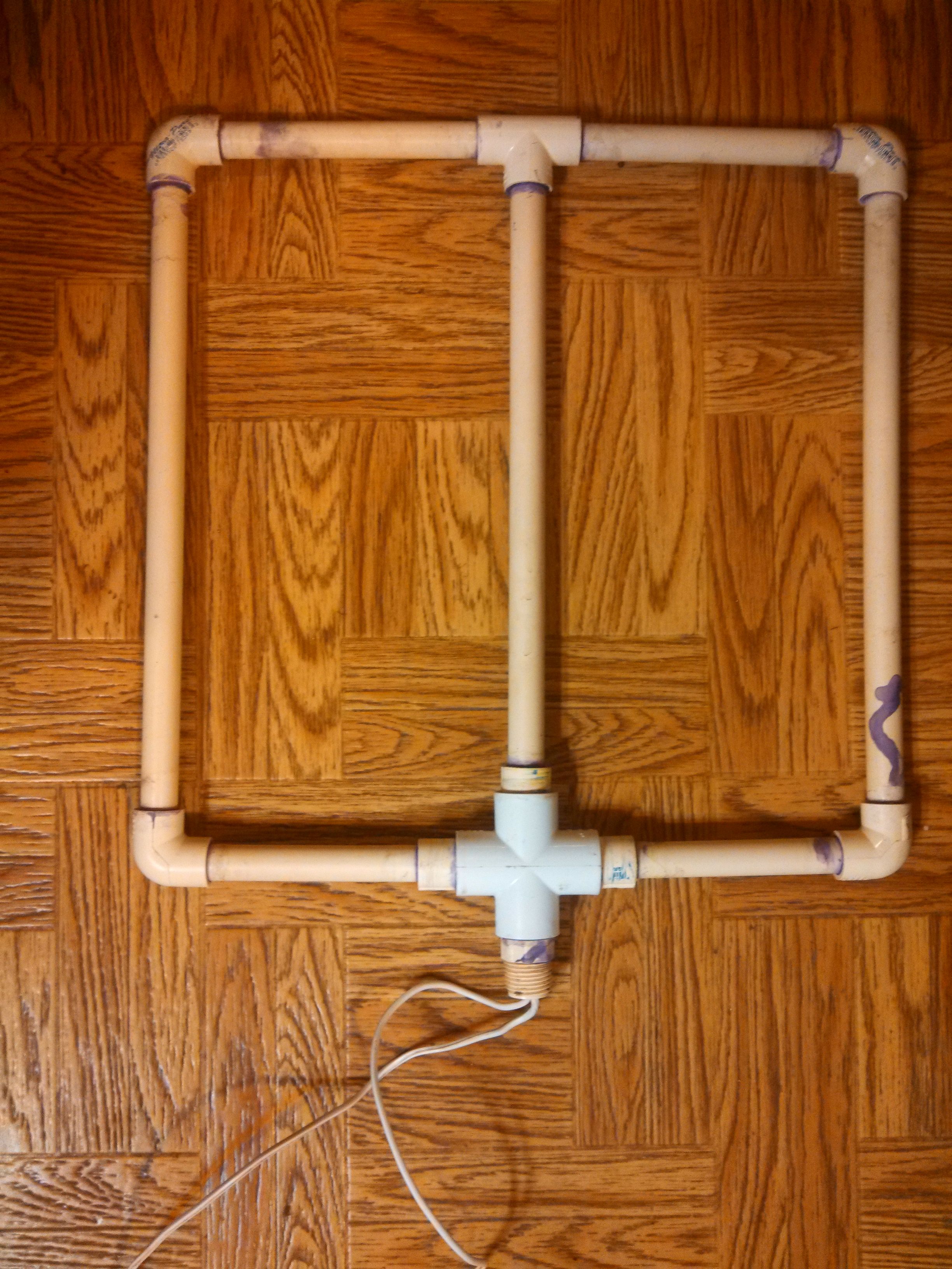

So, I started reading about class A stations, skip, and all this other really interesting stuff about AM and I naturally got to thinking about a rooftop antenna for it.
So last night i finally started building (basically) this, http://www.mile204.us/PotsdamDan/RubeGoldberg/Ultimate_AM.html
Instead of 1 wrap of phone wire, I used 2 wraps of lamp cord. Both equal out to be 4 turns, but I just had to solder 1 connection together in the pipe. I did that just before gluing the last pipe connection.
I also added a center support and a threaded base for putting on a tall PVC pipe to keep it isolated from a rotor that I'm dedicating to it.
I am planning on using some microphone cable that I have on hand to hook it up.
Its shielded, so I think it should be good for keeping out interference from household wiring and such.
http://www.alliedelec.com/search/pr...NqT993EYMHYg5QSEclD-HV9qmQ6ncYvTcEaArqt8P8HAQ.
(REALLY good for actuator signal wire as well.)
I finished it really late last night, but still had to hook it up and see how well it worked.
Here in the house, with it just sitting on top of my tuner, even underneath a tin roof, there were tons of stations that came in good all across the dial.
I'm gonna spray paint it green to match my roof later on today, but anyway, attached is a pic of how it looks now. :)

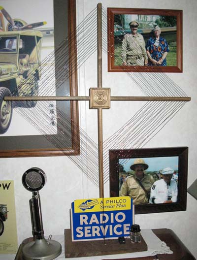

I have three different primary rigs for DXing. For the older tube radios I built this AM loop antenna with a variable capacitor. I have a Panasonic RF-3100 as a daily driver. I'm in eastern PA and often listen to AM740 Toronto, especially on Big Band Sunday Night. For solid state tinkering I have a Realistic DX-300 Wadley Loop receiver connected to about 100' of outdoor longwire running north to south about 12-15' off the ground.
