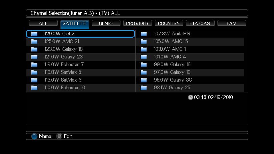

Therefore, I intentionally deleted every satellite that was from the eastern hemisphere and many of those that were in the western hemisphere, but that I could not view from my location. This helped considerably.
I am very particular about how my list appears. The most recent thing that I did was attempt to delete ALL the satellites from my list. DON'T DO THIS! THe AZBox doesn't like this. I found that it actually won't really let you do this, but it will sure scare the heck out of you if you try! So, you can delete all but one. Leave that one last satellite alone until after you add one back, then you may go ahead and delete that last one. This is a LOT of work, but I found it worthwhile in the long run. I guess.

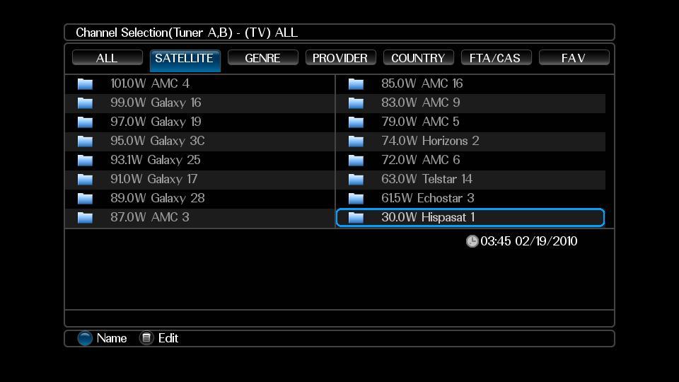

Yes, this is fine to do. It sure made the process of searching through the entire list much easier. We here in N.A. cannot view those eastern hemisphere sats anyway, so why have them in the list?
I did quite a bit of work cleaning up my own Premium AZBox satellite list and after all was said and done (and I had scanned the Ku Band channels that I was able to receive) my satellite list resulted in appearing like this (see attachments).
EDIT: I noticed that when you edit a satellite (enter a new sat) that you are not allowed to enter as many characters for the sat name as some of the stock satellite names originally had. I don't understand why this is. You would think if they had a satellite name as long as 101.0°W AMC 4 North America that you could reenter the same name if desired, but it doesn't allow this. For instance, on Hispasat 1C/1D I could only enter "Hispasat 1". Maybe if I tried this editing or adding using an editor program it woud allow this or maybe there is something unique about he text font or size that is different. I am not certain of this yes.
