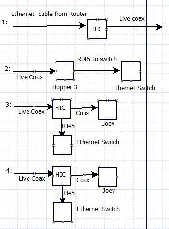

I'd like to see a diagram of that!
1: Supplies ethernet to the Dish Coax.
2: Reset network con Hopper 3 and it will find the HIC for a wired connection.This switch connects my Fire TV, Blue Ray, Onkyo receiver, two internal wired security cameras
3: This is in my Master Bedroom, and the switch connects my Roku, (not so )Smart TV, wireless access point for this side of the house.
4: This is my Guest Room and the switch connects my Fire TV, wireless access point for this side of the house.

I just bought a Dish HIC but it did not come with a manual or wiring diagram and I can't find any on the internet. Does anyone have one? If not, what does the Mode 1/ Mode 2 switch do? It looks like the HIC is just a pass through for the coaxial so why does it come with a terminator on one side? I have the hub in our bayside closet near the dish and have a cable to the Hopper 3 and a cable to the Joey 3 from there. Does it matter whether the HIC is connected to the Hopper 3 cable or the Joey 3 cable?
Definitely needs wired to the client(Joey) side of things. The pass through is for when the hic is in another room with a Joey, and you can wire in an Ethernet cable directly from a router. If you're not using the pass through, you want to keep that other port capped, so you're not leaking moca signal. We also use the hic to move a wap closer to a wireless Joey if necessary.
Exactly, when not using pass-through you want to keep it terminated, such as #1 in my diagram.
I have no idea what the mode switch does, I have never played with it, as it worked in the default position...

Thanks, everyone. The HIC rocks! I did have to reset the Hopper 3 a couple of times during the installation, but other than that, everything went smoothly. I did not detect any degradation of picture on either TV and internet speed is much better than wireless. I connected one of the HICs to the Joey cable near the router as osumike recommended and the second one at the Joey 3 connected to a switch. Both were set at Mode 1 (whatever that means). I connected the Hopper 3 to an Ethernet over Power adapter and another one on the opposite side of the room and connected that to my WAP. I now have internet at our pool and on the beach!
