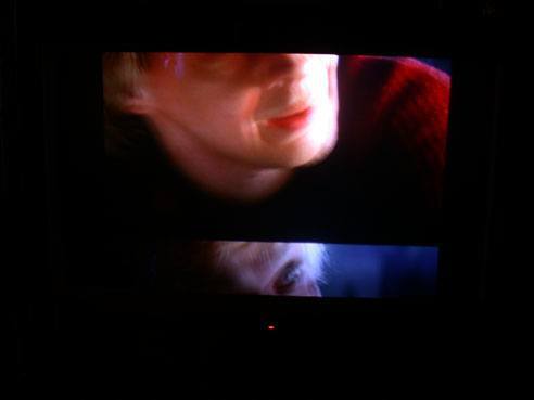

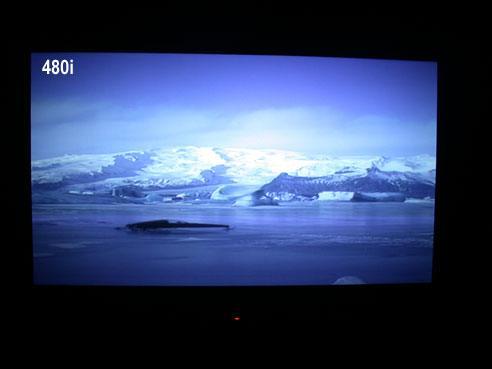

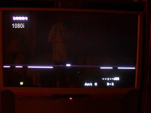

Is it possible for you to post a picture of what your screen looks like when you try inputing 1080i?
Pictures of how it looks in 1080i
Here are some pictures of what it looks like in 1080i, 480i and ANT C.The camera wasnt able to capture the black bars running across the screen. Behind the 3/4th formating and the bars it looks like a really niced picture in the 1080i mode. Notice how Ant C looks just like 1080i mode with the picture in the same place? Note nothing is hooked up to ANT C.

Well,
I just got off the phone with Hitachi Phone support and I think I finally got a solid answer. He said that it sounded to him that it was a equipment problem with the HD equip module inside the TV. I tried every suggestion from everyone and really appreciate all your help - unfortunity none of it worked. I think at this point I am going to demand an authorized hitachi tech to test my HD TV and replace the guts. I will post if this solves the problem. It really is the only thing that make sense. The DVD player works with component and not the HD receiver. Well, it looks like I wont get this fixed in time to see the tyson fight next friday, but I guess he has a few more fights to go before he gets out of debt.
Since you are seeing a similar problem on the ANT C input (which has nothing to do with VOOM), the problem must be in your TV set.
