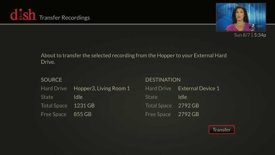

I was able to get a 3TB HGST internal drive to work in the Sabrent enclosure. The H3 formatted it to 2.8TB.

I just tried the Sabrent Enclosure with a 3TB Toshiba P300 Desktop Internal Hard Drive and my H2 recognized it out of the box, no additional formatting required. 2793 GB. I just wish I would have known this before I bought my two 2TB drives.
