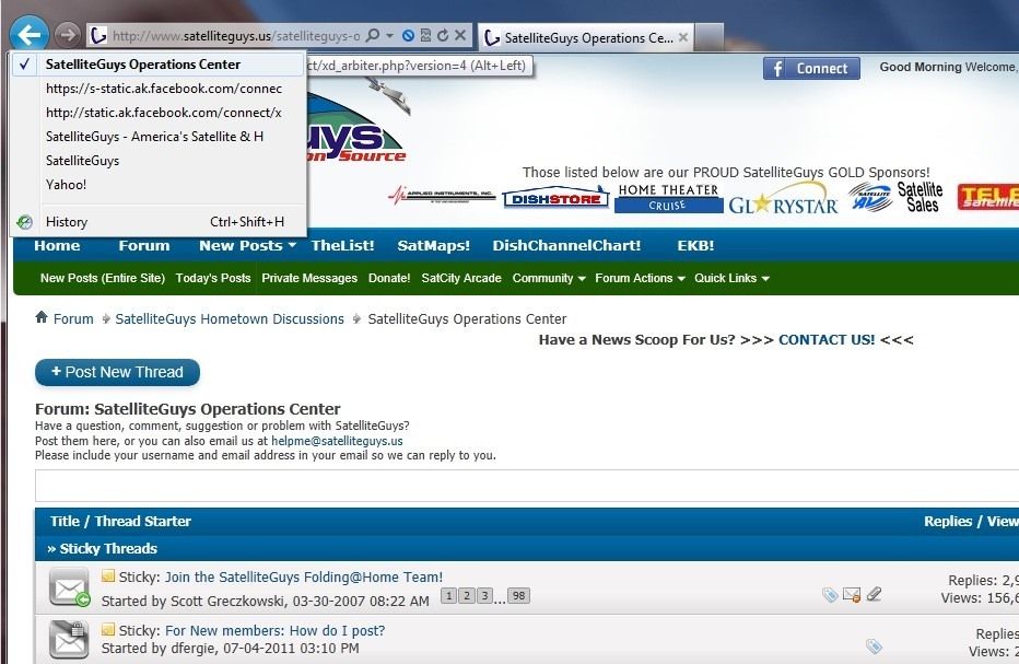

Today when browsing around when I go into a thread I then use the back feature to go up to the forum. Well now it is not working because the browser history is filled up with facebook connect history. Probably some new feature of VB gone awry...

Of course I am using IE at work, so perhaps it is IE only. Reproduction is go into a forum, read a thread then back to the forum and try to then go back to the forum list. If you look at the browser history it has a bunch of facebook connect history built up.
Here is a screen shot.

I can fix it by logging out of facebook. It is the facebook connect feature. The reason it probably hits me and very few other people is that I have facebook set to always use https. So, the facebook connect does the http then the https (as you can see by the screen shot I posted above). The script does not back out properly. It started when the last update was done. Probably a vbulletin bug that may eventually be fixed.
More investigation... it seems that there was an interaction between no tracking and facebook. It looks like facebook is using its connect to track, and my tracking blocker in ie9 was blocking it. It looks like it is on facebook's side of things, they are doing something to track.
