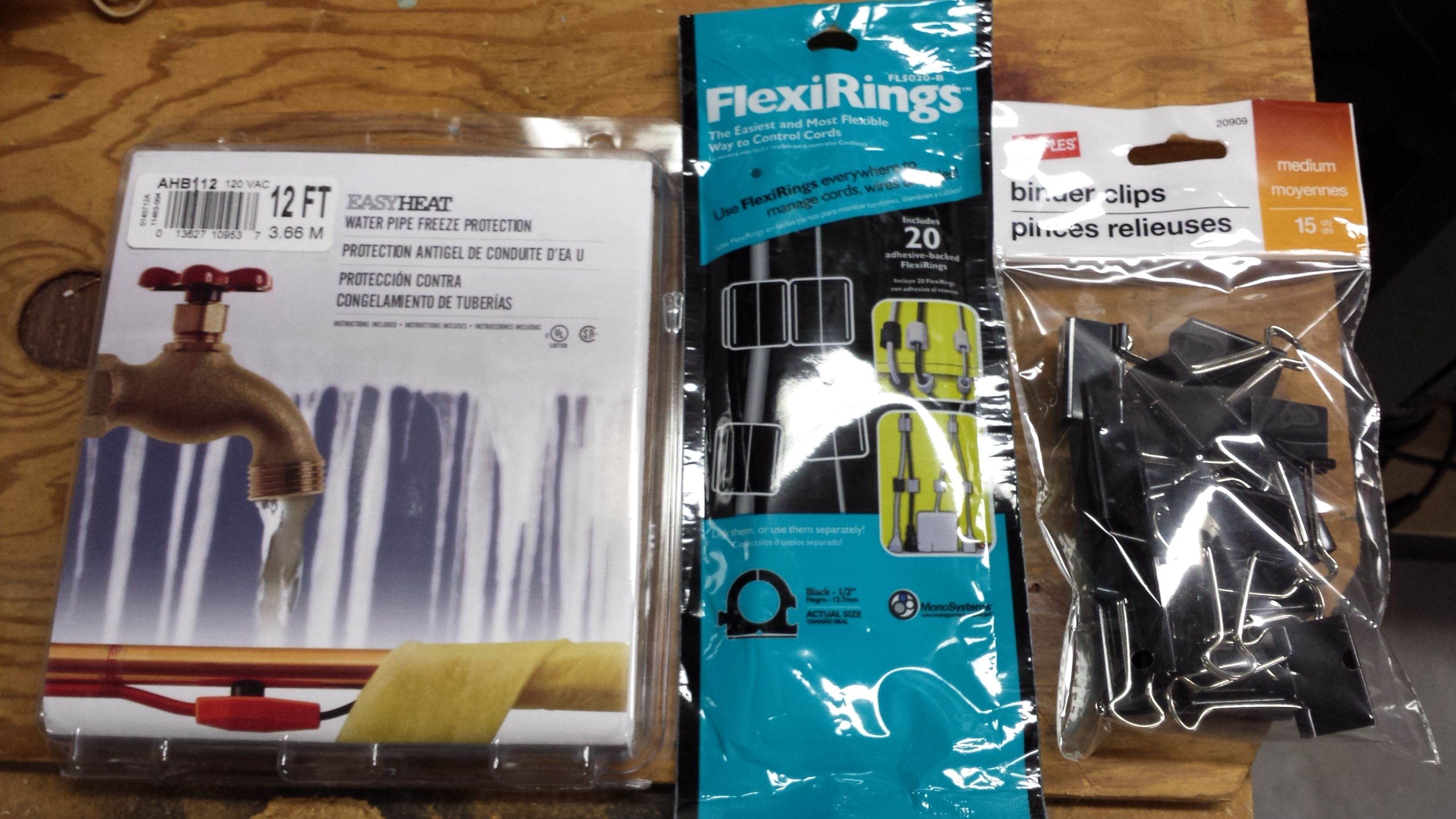

First, go to Lowes and Staples and buy the following:
1 - 12 foot EasyHeat Tape for pipe heating $27.94 at Lowes.
1 - package of 1/2" Flexrings (20 Pack) $4.98 at Lowes electrical department.
1 - package of Binder Clips (15 Pack) $5.00 at Staples.
1 - package of 1" 3M automotive double sided tape about $5.00 almost anywhere.
1 - small bottle of GooGone.
When you get home soak the Flexrings in GooGone and remove the crap tape they use... if you skip this step you'll be back! Wash and dry them thoroughly and a apply a 1" square piece of 3M tape.

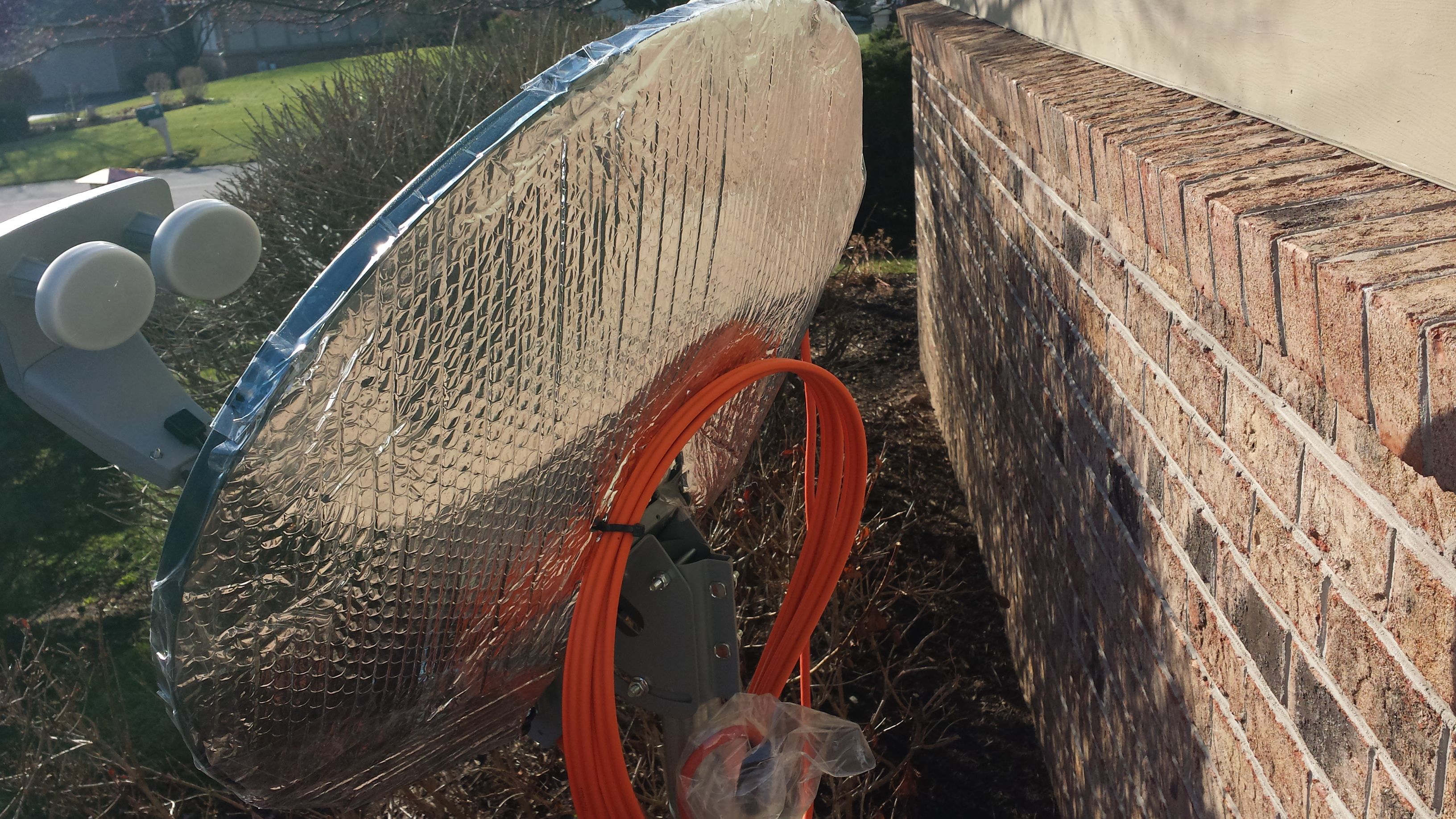

Then go to your dish and route the heat tape however you want concentrating most of the tape (and heat) at the bottom where most of the snow will accumulate. Here is what I did for my second iteration (there may be a third and fourth after the next snowfall).
Then place the binder clips and Flexrings as appropriate for your routing of the heat tape. Make sure the thermal switch near the plug end of the heat tape is in contact with the metal part of the dish. Note: Be careful to place the heat tape in the empty space at the flat side (closest to the camera) of the binder clip so that the heat tape is captured, but not pinched. Critical!

Update:
The second heavy wet snow we had (about 4-5") was too much for the heat available from the tape, so I stepped up to v3 by the addition of some insulation on the reverse side of the dish. It is placed so that all adjustments can still be made by the tech. The insulation was cut to size on several pieces and held by 3M packaging tape.
