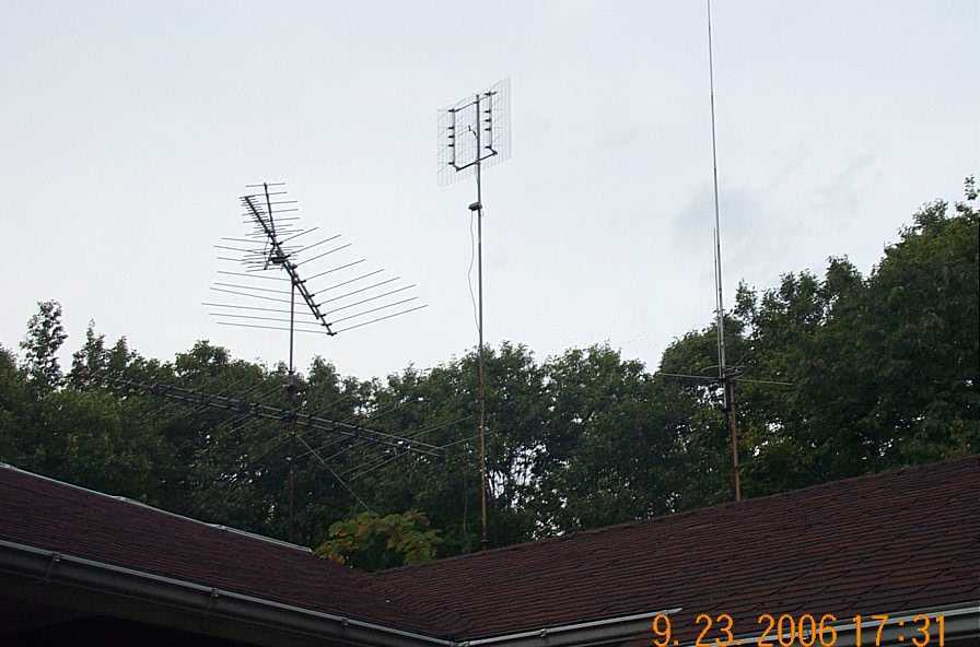

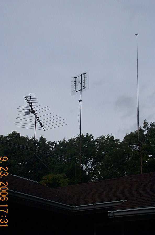

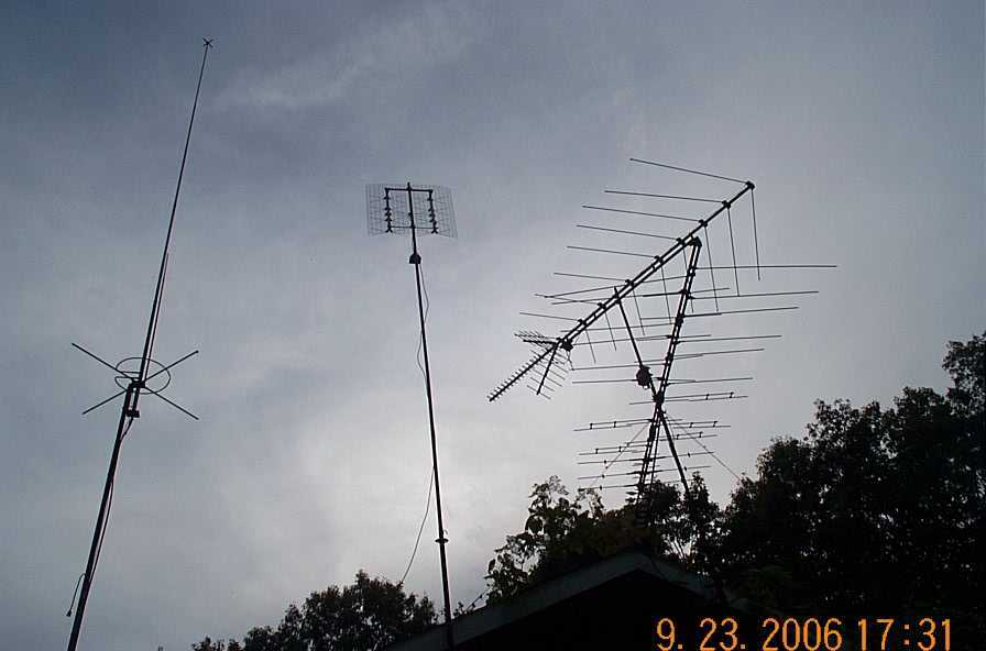

So I thought the best UHF antenna and a good low-noise preamp should do the trick. I started with just the CM4228 and some new coax (not sure of the quality) with all new compression fittings, and it made no difference. I had it mounted on the same mast as my old CB antenna, just below the radials which put it about 5' off my roof. I then added the CM7777 preamp, and again no change. I thought moving and/or raising the antenna would be the answer, but that was a bigger project than I could commit to until last Sat.
I had an old telescoping mast that is about 23' long. I added another 10' mast from RS to that and mounted the 4228 and preamp to the tip, and raised it temporarily between my other antennas. Voila! I can now receive 24.1, 24.2, 24.3 and the PBS subchannels on this set-up well enough to consistently lock them! The meter in the TV indicates 60/100 most of the time. Both the TV and the 622 were able to lock them and I get almost no drop-outs or pixelation on either (the TV is still slightly better). Boy did the Sat. college games on ABC look great in HD !! Now I need to determine what it will take to get 32.2 (CBS) from the same location. They might be at lower power presently.
Maybe someday I can luck out with this rig and also receive NBC on essentially the same bearing. Unfortunately it's about 30 miles further away, about 55 mi. total, so I don't have much hope for that channel.
NOTE: This is just a TEMPORARY set-up. I still need to ground it, weather-proof all the connections, secure the coax, and reinforce the mast with guy wires, all of which I hope to complete this weekend. I might eventually add a rotator as well. I don't think any of my channels will remain on VHF after the conversion date, so eventually those old V/U antennas will come down.
Interesting experiment - I am concerned about how that antenna/mast will survive without guy wires, not that I intend to leave things that way for long. On Sun. it was a rather windy day with gusts to 15mph. The 4228 was moving in that breeze, but not a whole lot worse than the CB antenna!
Small steps to the final goal! I can now recommend the 4228/7777 combination!
