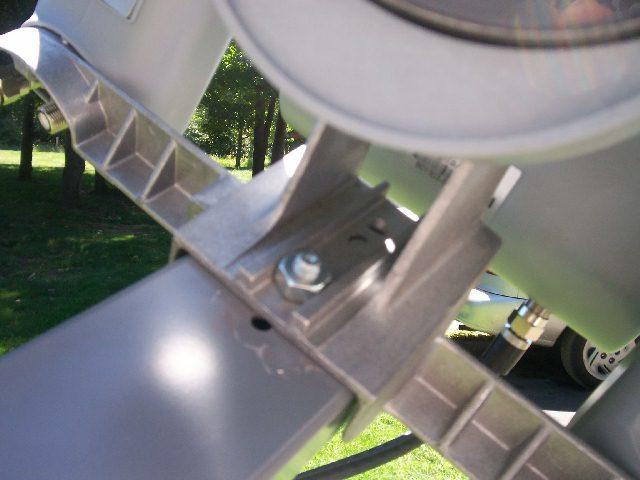

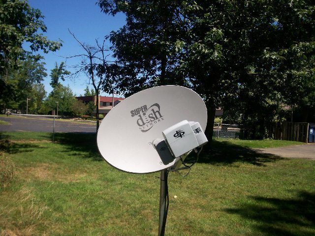

Had a little time to play today. So tried to mod a 121 Superdish to work with the new 1000+ LNB array. Just so you know it is a pretty easy switch. Just a matter of removing the old LNB array and drilling a couple of holes so the new array will mount to the polar arm. Then just had to fine tune the skew and elevation to peak it in. Works well, and gets good signals on the 129 close to and over 100 on some transponder.
Here are a couple of pics for you. The LNB pic only shows the one bolt as I was just testing.

Skew it at about 124?
Was messing with my 1000+ today and could not get all 4 sats at once. Wonder if I did not have my skew high enough. Dave what skew are you set at? Your install looks skewed quite a bit more. I was following the instruction manual and did not try adjusting skew.
Elevation 30
Skew 118-121
1000+
Just a word of warning. I found out the hard way that you don't want to tighten the screws too much to attach the outside LNBF's. The cheap cast metal will break. I have only installed a few of these but they are easy to tune in and installl
Tell me about it, I broke 2 of them on Friday when I did an installation. Had to go back to the store and get another LNBF assembly :(
Elevation 30
Skew 118-121
Skew on that setup was about 123 thats where I was getting the best signals between 129 and 118. I did not have the 110 hooked up while testing the 129 because I did not have any DPP44 at the time. But on initial set up it was 110 so I figure it should still be way over 100 when I was peaking for the 129.
I have more numbers I just did not bring them home with me. Some transponders were in the 80's on 118 other were in the 40-50 range. Still finding out what the proper transponder is to see what signal should be.
I think the problem with this is the polor arm will flex to much allowing the nut to pinch the metal on the LNB array. I noticed this on the 1 and only dish500+ we have seen at or shop (got that yesterday on it went on an install right away so I did not get to play with it much). The superdish arm is much heavier and I did not see a problem with it braking the metal on the array.
As for the little side brackets to hold the singles yeah they are not the strongest of things. The old superdish was set up pretty much the same, and I only ever saw a few of those break, and that was in the installers truck on the way to the job.
