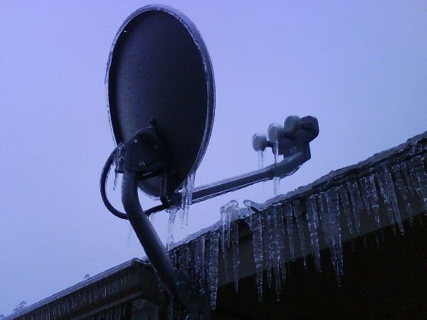

I lost my signal down here in Norman briefly due to ice buildup on the LNB. Didn't take much to get it off since the ice didn't seem to stick and it pretty much fell right off. I did, however, have problems with ice accumulation on dish itself which left me having to run check switch every so often on Monday night. Now all is back to normal that the ice has finally melted.
