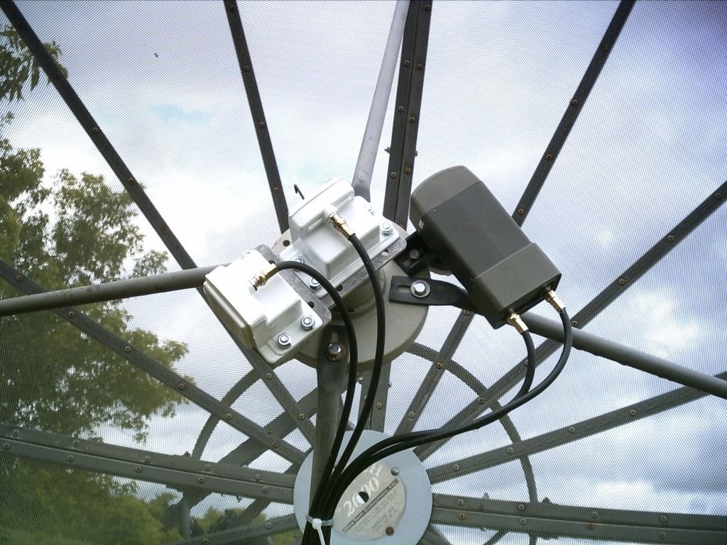

Im trying to just add ku to my cband that I am trying to get set up. I took a lnb bracket holder and used one of the unused holes in my scalar ring to bolt the holder to. Before the mover gave out I was trying to hit a ku signal but was unable to do so. I got my gbox back today and will try again this coming weekend. I know that my scalar is parallel to my dish so I am thinking that I may need to tilt the bracket to the center of the dish to receive signals but unsure of this and how to do it. I may have to use some other type of bracket that can be bent at a angle as the plastic will not bend unless I can come up with some type of a wedge to tilt it towards the center. Maybe mount a light gage piece of metal on the scalar and then mount the plastic mover to it then I would be able to bend it to aim at center of signal. Any suggestions?

Circular Ku LNBs are very forgiving and can probably be mounted in that fasion w/o issue. I believe linear ones will be another thing altogether. I'd say the best way is to use a dual band C/Ku feed assy, and eliminate all tracking and polarity offset issues.
I see you have dual C outputs. If you need dual C feeds a one pass/one block splitter should serve well. I use a PV brand unit to split my C feed between the 922 and my DVB stuff and havent noticed any signal degredation. The downside is that the pass port receiver must be on to power the LNB any time you want a C band signal.
Co-Rotor II's are the schnizzle, but it depends on how deep your pockets are if you want to go that route. Some others may be able to advise better on the method you are trying now. The only thing I see that I would do to try it is to mount the Ku parallel below (instead of to the side) the C feed when the dish is at it's highest point in the arc. That should be the best location to compensate for the polarity offset across the arc. As for focal length, scaler, etc, you'll have to get the Gurus input on that.

You lost me on some of your comments. Im not familiar with (one pass/ one block) splitter. I plan on using a zinwell 6x8. I have 5 of them and am going to try to link everything together with them and 1x4 diseqc switches.
I mounted the linear to the side in line with the scalar thinking that after I get it aimed at the center of the signal that while tracking it would be the best spot for the signal. But I am new to this and just winging it. I appreciate the suggestions.

To clarify before moving on, the terms one pass/one block are meant to refer to a 2 port high freq sat signal splitter that allows DC to pass on one port and is blocked on the other. They allow you you use one lnb feed and keeps your rx's source voltage output isolated from each other. (protects the rx's from each other)
I cant say for certain if being to the side as opposed to the bottom will make any difference, I've never done any field test of either orientation. I say the bottom because the track is E-W, the rotational axis is (essentially) N-S and being below (or above) should not introduce any error in the azmuith tracking geometry. Polarity offset (skew) is directly related to inclination/declination (think azmuith to elevation relationship) tracking adjustments.
Then again, it may make no difference at all. It is a worthy experiment. Let us know how you made out.
