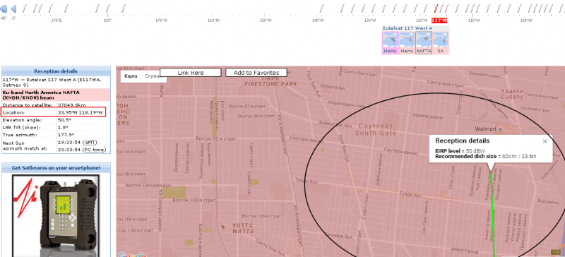

Open = http://www.satbeams.com/ = Find your place-house ..latitude and longitude entered in the receiver. Align the motor on the satellite 117w to the point -0-.Dish -Aziumut- set to True azimuth: -177.9 ° .If the photograph. Slowly lift your upper-down .Elevation - = 90-33.95- = 56 degrees.-.some will have you

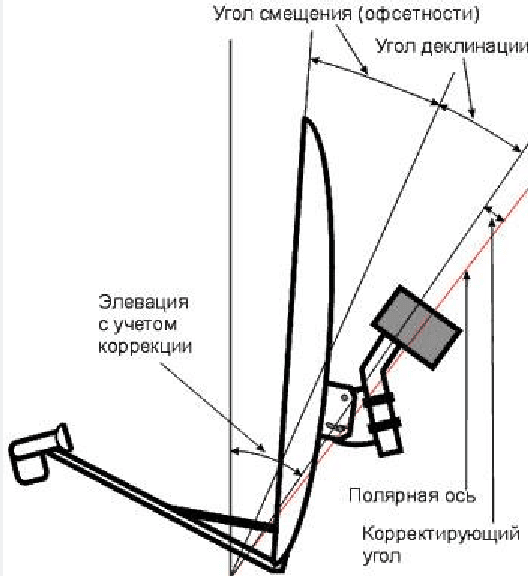

Elevation - is one of the most important angles of the suspension to adjust the polar satellite antenna. In order to receive all available satellites, it is necessary that the antenna is rotated around a specific axis. This axis is called the polar and it should be parallel to the Earth's axis. At the equator, the polar axis is parallel to the earth's surface than the north point of the reception, the smaller the angle from vertical is different inclination of the polar axis. So here is the elevation angle, which is inclined relative to the vertical axis is the polar angle of elevation is defined as follows: 90 ° - latitude reception space. For example in your ldom South Gate- elevation = 90 - 33.95 = 56.05 degrees.
"ELEVATION" -Your approximately- = 56 degrees
