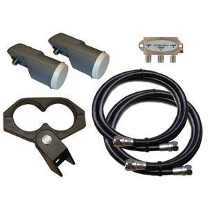

I've been working on a generic GloryStar like setup. I had considered two different LNB's that have 4 degrees of separation.
I can see several advantages of the GloryStar upgrade kit and it is less expensive.
Which one would be better? The GloryStar upgrade kit or the Sadoun Monoblock?

Glorystar system :)
-can make separate adjustments on the LNB's
-they're standard LNB's so you can use it with a diseqc switch or 22k switch
-the LNB's are both offset by 2 degrees so you get good results on both. monoblock one LNB is primed and the 2nd is offset.
Zinwell 4x8 or 6x8 compatible?
I dont understand the point of the post, but OK. Whatever
There is one minor error
if the diseqc is port 2, then you do not turn the 22k on. The 22k is only for Universal LNB's (which the Glorystar system uses Standard LNB's) or if you use a 22k switch (Glorystar system uses a diseqc switch)
Is it possible to use a zinwell 4x8 or 6x8 multi-switch to add multiple recivers? For the Glorystar setup. If so, how would I accomplish that?
For the stock Glorystar system?No as the LNB is a single output
Now if you rigged your own setup with 2 dual LNB's then yes you could use a 4x8 multiswitch

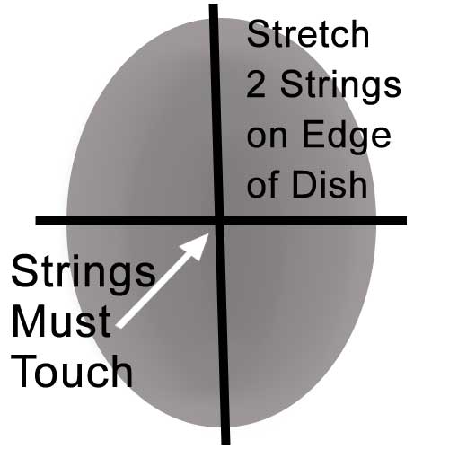

Consider these possibilities:
Blocked or partial Line of Sight issues causing decreased signal?
Dish checked for warping prior to assembly or the string test applied post assembly? see attached JPEG
Incorrect LNBF Rotation (Skew)?
Thanks. Your 100% right! My Dish has an abnormal arc. When laying on flat surface. The edges did not lay flat all the way around. Fanning it out could not fix this type of warp. Waiting on new dish and sending this one back. Thanks again.
String tested my dish a while back and found ~ 5/8" separation between the strings at the crossover. Flexed the dish on the mount until the strings just kissed. Raised my quality by 20 points on Gospel Music Channel. It wasn't that hard to fix on the pole, but makes me wonder if it won't droop back into the old shape after a while. (?)
