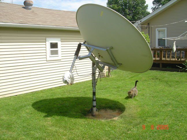

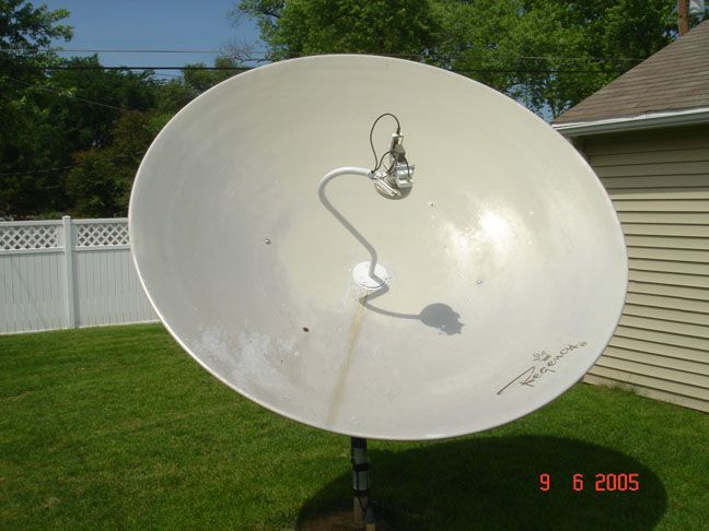

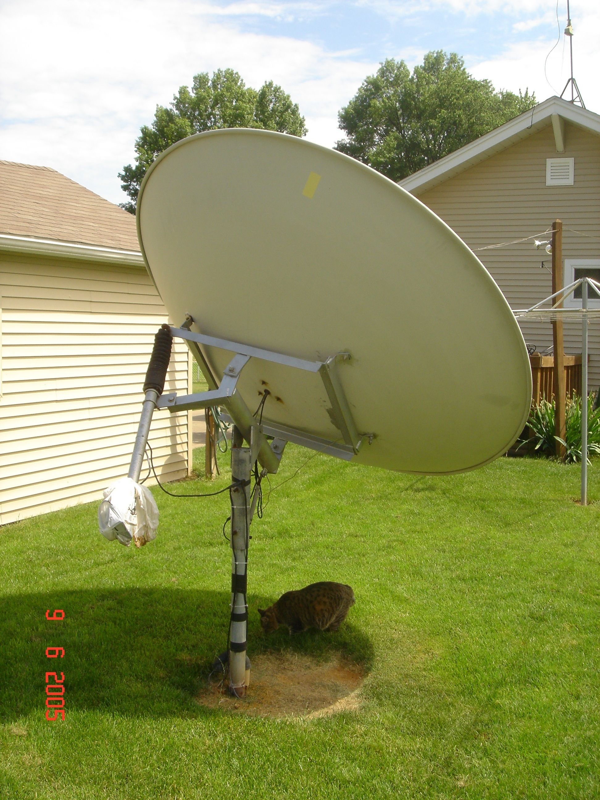

This would be it:
It looks like the declination is fixed (unless you shim the dish) on your polar mount anyways Jim. I wouldnt' sweat it :).

I don't have a mount for it, so that's going to present a problem. Also, the feed supports/assembly are for Ku. I need to find a buttonhook as on Jim's dish.
