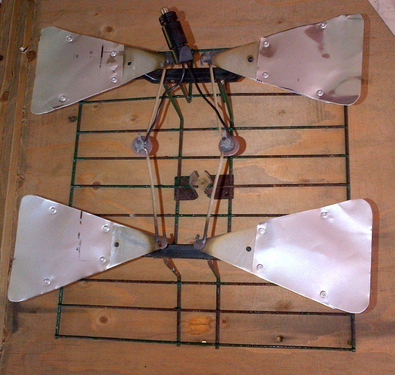

OK, first try was just to make the bow-ties bigger by adding aluminum flashing to the existing bow-ties. I really didn't think this would help much but it did have a very small positive affect on the signal. (This is labeled CM4251-Test1 below)

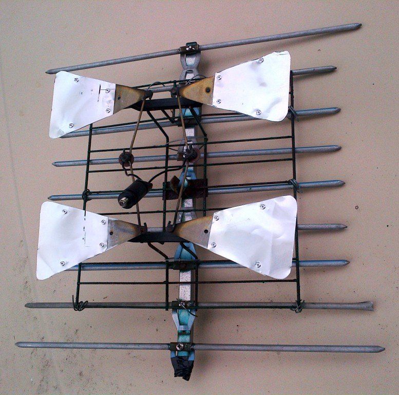

Second was the same aluminum flashing with a larger reflect behind it. I made the larger reflector using an old combo antenna and then wiring this to the back on the assembly used in test 1. (This is labeled CM4251-Test2 below) More on this one later.

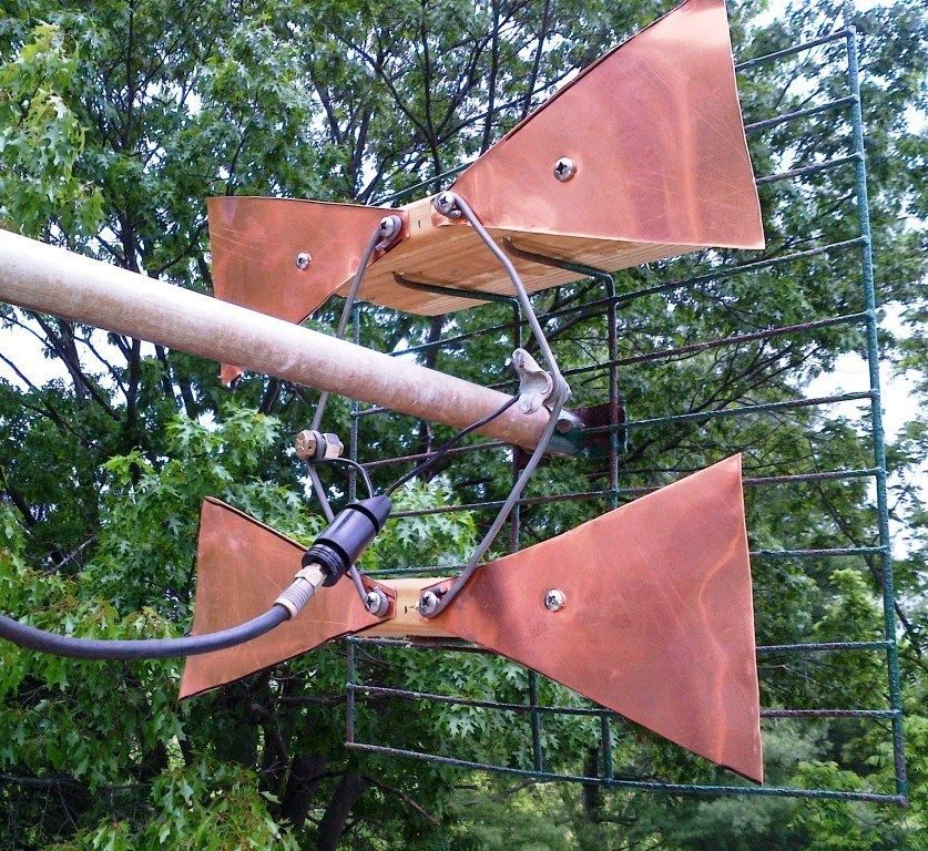

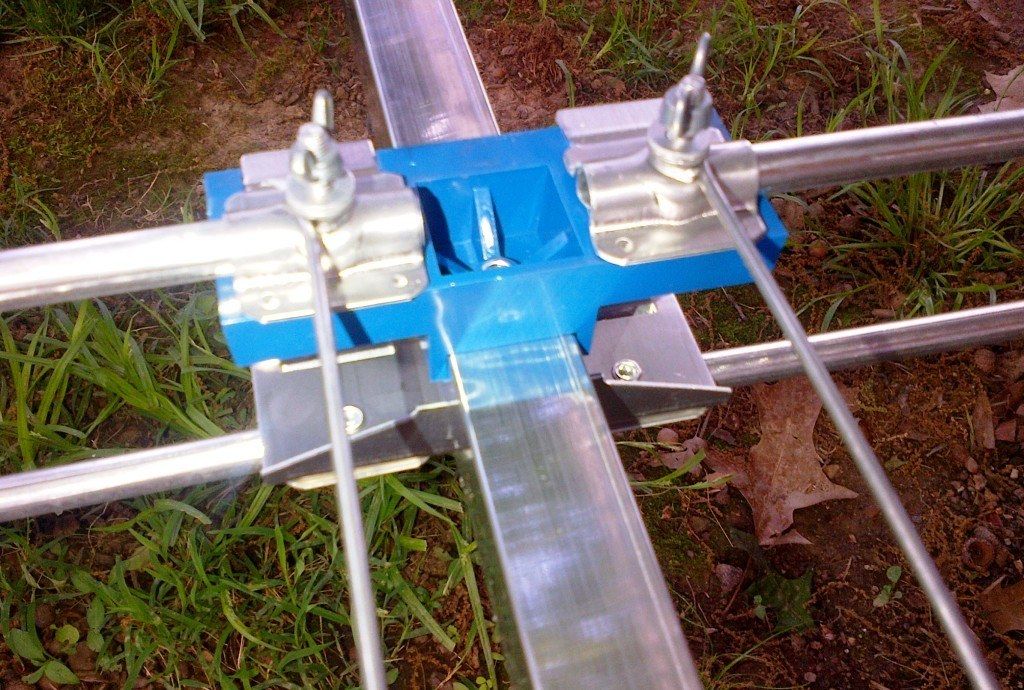

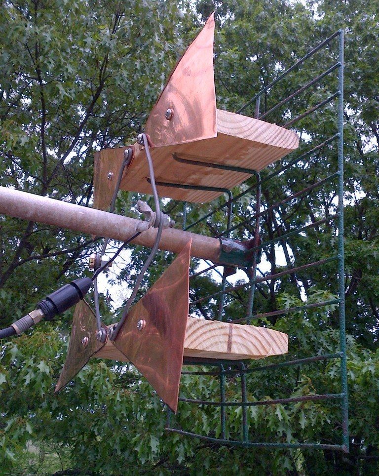

Third, I built a new one using copper flashing and stuff I found in the shed. This one was the most fun and took the most time. (This is labeled CM4251-Test3 and Test3a below).
So which one was the best?? Well everything is a trade off. I really thought the third one might end up best but it did not win. One problem with the third setup is that the wood blocks some side lobe signals and thus is not good for signals not on the bore-sight of the antenna.
The first test was good but with only limited increase in signal. So the best by far was Test2. Not only did it have the most signal - - - it also allowed me to receive all the channels that I want from Washington DC - - - including WETA 26-1 thru 26-4. One down side to Test2 was that it was very heavy but I don't think that should be a problem unless we get very high winds.
I currently have Test3 on the antenna - - - because I just too tired to go change it one more time. Maybe tomorrow.
Here are some PIX.

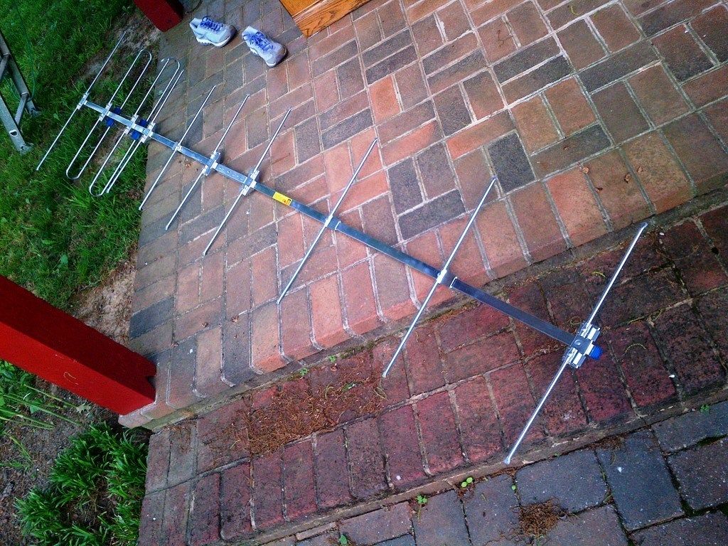

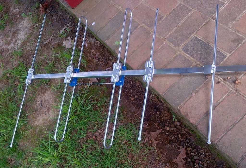

Also Upgraded the VHF antenna
The antennas being so close is likely not helping either. If in your shoes, I would replace the RCA combo antenna with the lightweight/low windload VHF-Hi Antennacraft Y10-7-13 & mount it at least 1 foot above or below the 4251. This will really help improve the dynamic range of the 7777 which is likely suffering from some signal clipping due to the strong local FM's in the valley.

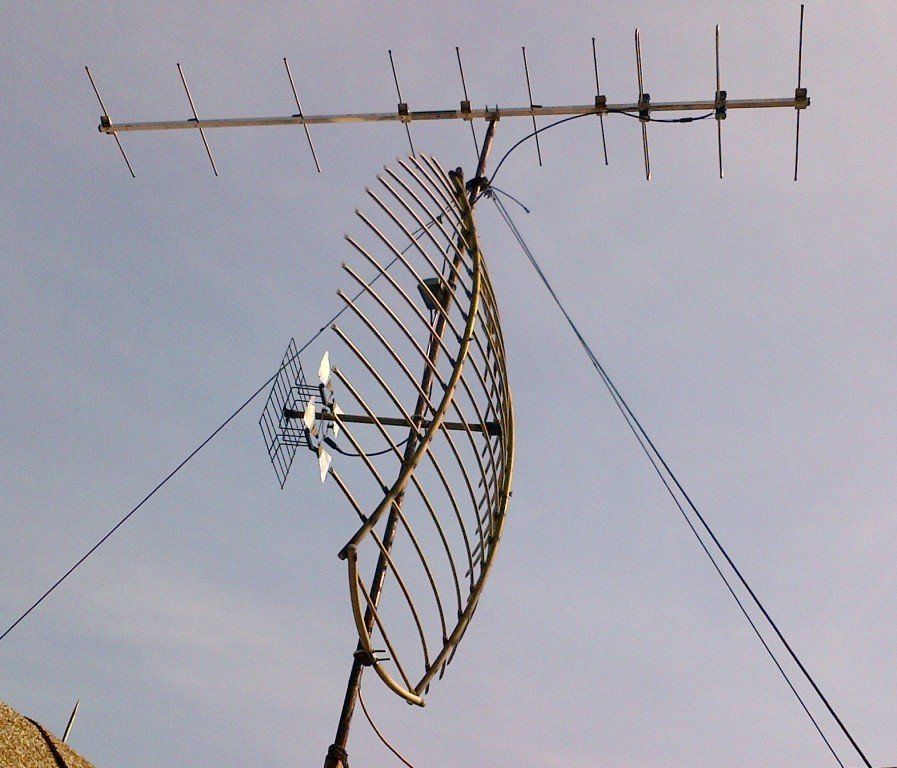

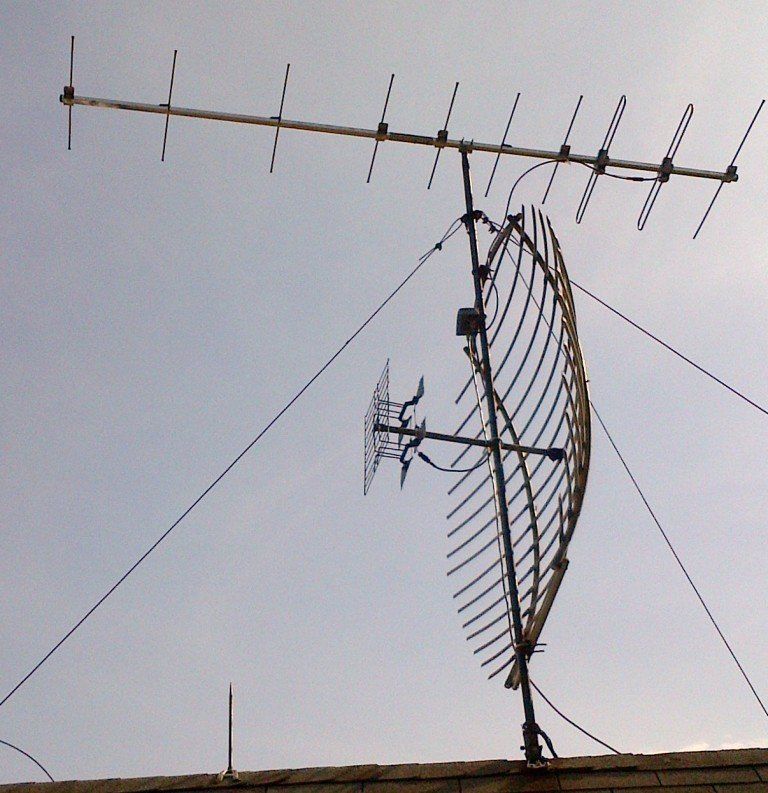

Also, I replaced the very old VHF antenna with the AntennaCraft Y10-7-13 as suggested by "No Status At All" - - - thanks Man!!
Anyway, I like this antenna a lot because it allowed me to get channels 7, 9 and 11 reliably but not 13. I still need to check the FM trap setting on my CM-7777 but have not done that yet. This may be still causing my Channel 13 issue.
I put the antenna as I high on the mast as possible so as to have the UHF and VHF antenna's as far apart from one another as I could on this short mast.
Very happy with this antenna and for the money it is definitely a great VHF antenna for channels 7 thru 13. If you have deep fringe problems with 7-13 I would give this antenna a serious look.

For your bowtie experiments I would try to shorten the gap between the small reflector and the bowties. Also replace that wood with plastic as it does reduce gain. The sheet metal can be replaced with tubing or heavy gauge wire bent to V shape. The elements could be lengthened to 8 or 9 inches depending on how low your UHF channels are.

Nice pix!! Glad to hear of your success!! Not sure how important channel 13 is to you??(good late night offerings & a few Ravens games not carried on 9) Unfortunately 13 is only beaming about 6000 watts in your direction. Their directional antenna limits power output to the west due to an interference agreement with channel 12 in Martinsburg. An FM trap from Radio Shack before the preamp may help if the internal trap isn't enough. Exactly how close are you to the WXBN transmitter?
I can see it from my house - - - - as the crow flies I would say about a mile. 13 is really not too important to me - - and does not even showup on a TV-Fool plot. I was amazied I even get channel 11. Both 7 and 9 have signal in the high 60's on the Signal strength meter on my Tivo HD and 11 is in the high 50's which seems to be enough to have no breakups at all.
Thanks again for you help - - - this AntennaCraft Y10-7-13 rocks!!!
