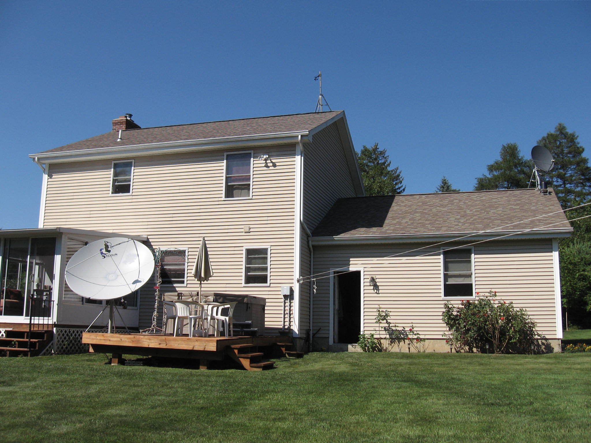

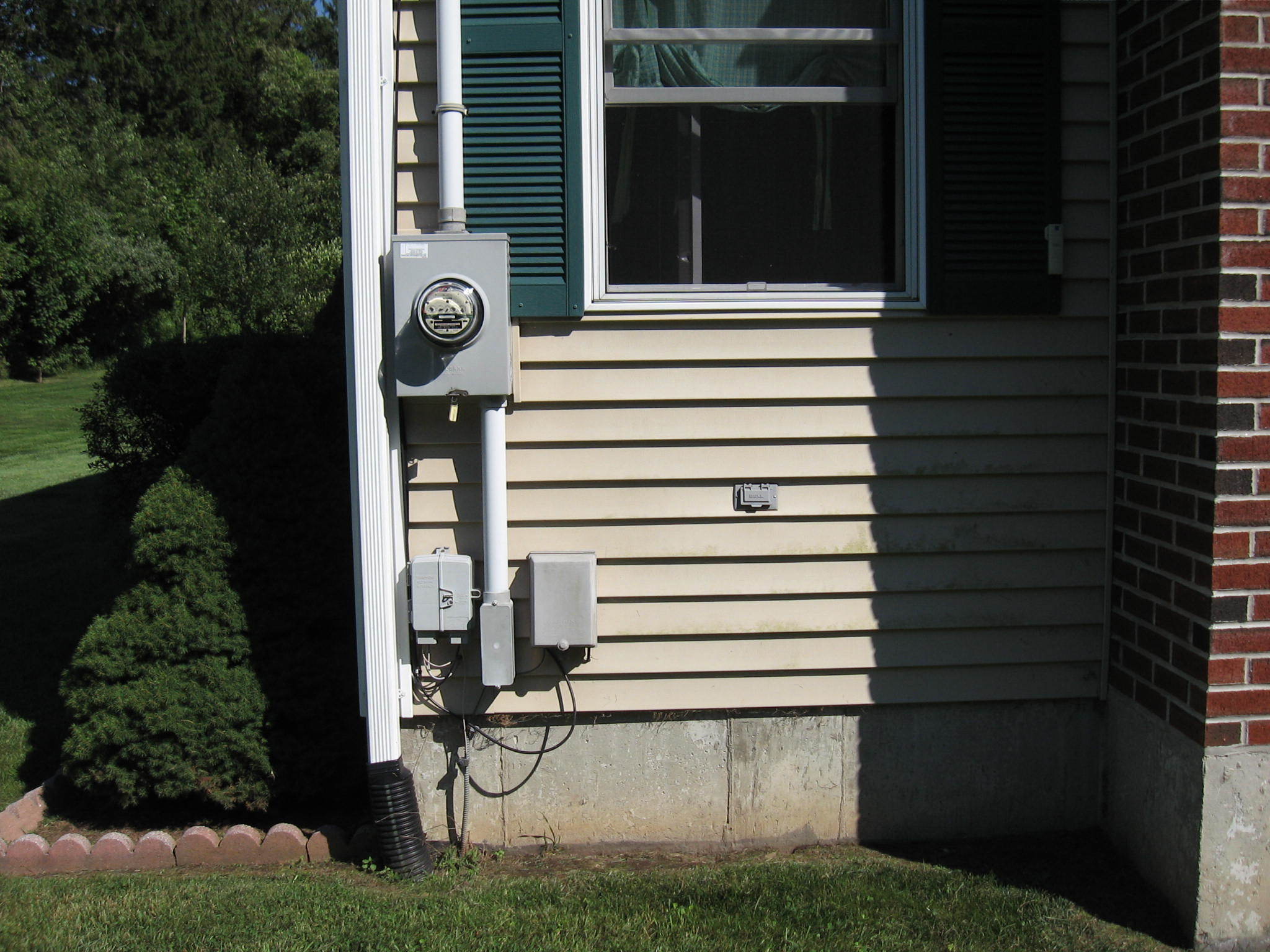

the garage is attached to the house!Outlets in the garage are snaked threw the firewall joining the house with the garage and all outlets go to one circuit breaker box located in the basement of the house.As you can see from my home pic is my 3ft,6ft and weather station!The weather station and 3 footer are grounded to a grounding rod located on the corner of the garage below the 3 footer.The main house ground shown in the other pic is by the fireplace located at the other end of the house shown in the house pic.The wire comes in late next week so planning and doing the grounding update next weekend,If anyone has any ideas on the best way to do this feel free to put your 2 cents in.! Thanks Stan
Pictures can be worth a thousand words....first off don't ground to any of your outlets with a ground wire as you garage is attached and like you wrote they go back to the main panel.. I would take the new wire your getting and make sure all your equipment is connected to a ground rod and then make sure that all the rods are bonded to each other and to the main rod where your power comes in. And you can connect a wire from any grounding blocks your using to the ground wire.
