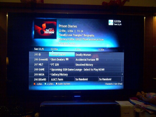

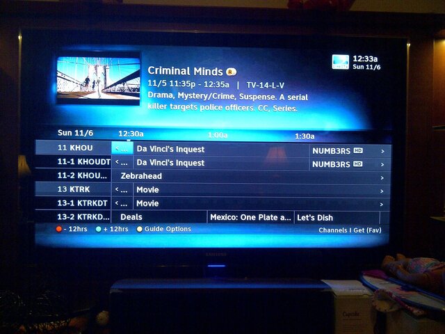

I love the new GUI; however, I don't understand why, just like the previous guide, it isnt wide screen all the time, rather than be based on the actual broadcast resolution of the tuned to channel (e.g. 480i)? I imagine it has to do with the PIP being shown in the upper left, but still I don't see why the guide can't be 1080i all the time with the PIP at 480i or whatever resoltion is being broadcast for the channel.
The first picture shows when I am tuned to Channel 285, which is being broadcast at 480i, and the second shows when I am tuned to Channel 11, which is being broadcast at 1080i. You can see the 6 inch wide black bars between the Picture and the TV's bezel on the 480i picture.
You likely have your output setup as NATIVE = ON; change it to NATIVE = OFF; SCREEN FORMAT = ORIGINAL and set/press the FORMAT BUTTON to set either 720p or 1080i and ORIGINAL
I tested mine on the same channels as you and mine was always wide screen. (I had to use my local chnl)
chaper1 - Thanks for the help. I have done as you suggested using 1080i resolution + Original format (Screen format is unaltered), and yes now the menu is always wide screen, however, so are the broadcast pictures. Channel 285 has just narrow bars on the top and bottom of the screen and 246 has no bars at all. I don't understand how it is filling the full screen width now though without altering (stretching or zooming) the original format.

Sounds to me like 1 channel is hd and is filling the Chanel correctly, while the other is a channel showing a sd program.
The smal bars at top and bottom are normal depending on the format being sent out.
Jimbo - Both channels are broadcast at 480i native. When the box is set to 1080i resolution + Original format (Screen format is unaltered), somehow the picture manages to fill the full width of the screen with no apprent alteration (stretching or zooming) of the original format. It is a welcome improvement over using Native as I have been; I just don't understand how this is being achieved. I mean how can a square image be converted into a rectangle image without alteration?

Check the format of your television also.
as mentioned not all HD programs will be 16x9 aspect ratio and fill the entire screen; not all HD channels show "full 16x9" all the time; some will be pillar-boxed and some will stretch full-screen; make your TV setting to display "NORMAL" or "ORIGINAL"
In other words OP, currently, because the way programming is, there is not going to be any one size fits all setting that makes everything look exactly the same way all the time.

If you have the aspect ratio to pillar box on your receiver, the UI gets squished. It would be tough to have the guide be displayed in 16x9 format because the TV or receiver would have to change formats every time you pressed a button when viewing an SD channel.
I do not have mine on pillar nor did I say to set it to that; what I said is that some HD channels and programs will not always be 16x9 (or the appearance of full screen) and may appear pillar-boxed. I should also add some may appears and letter-boxed or window-boxed.
Not exactly sure how you misconstrued me to be advocating the pillar-boxed setup though.
