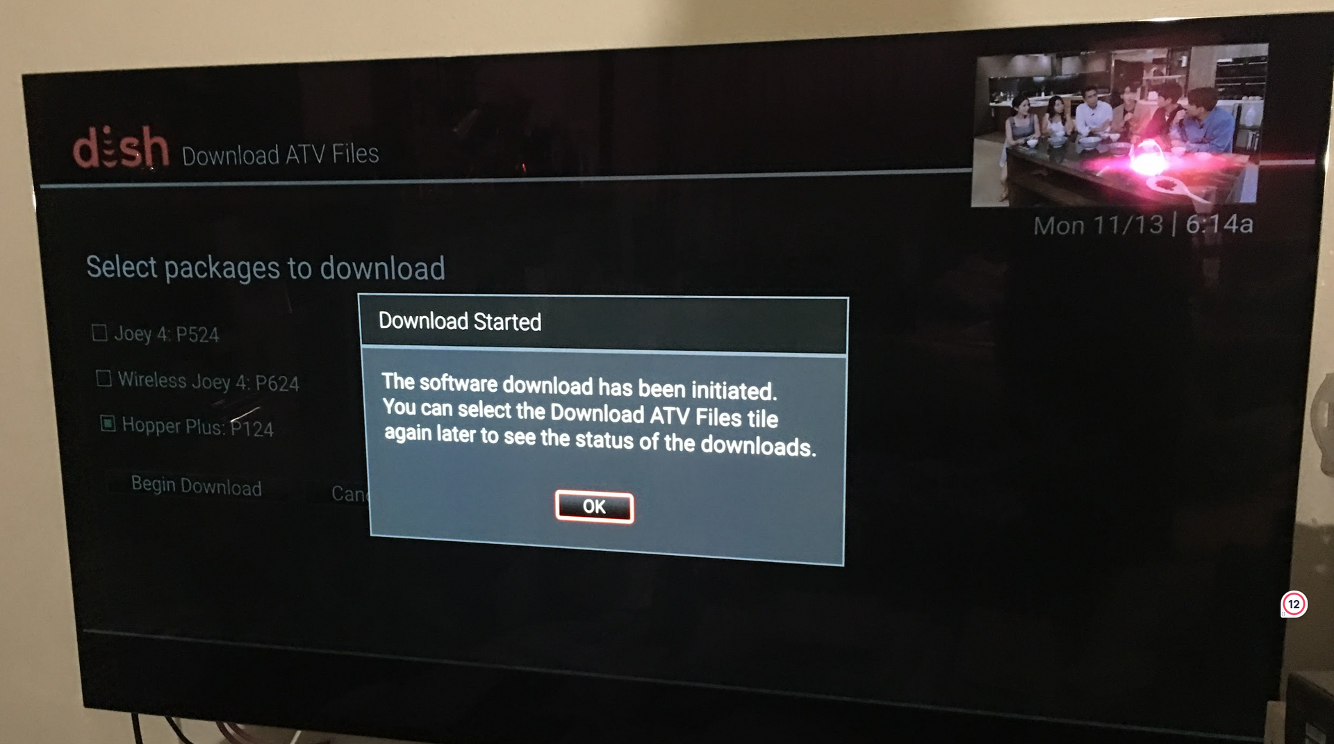

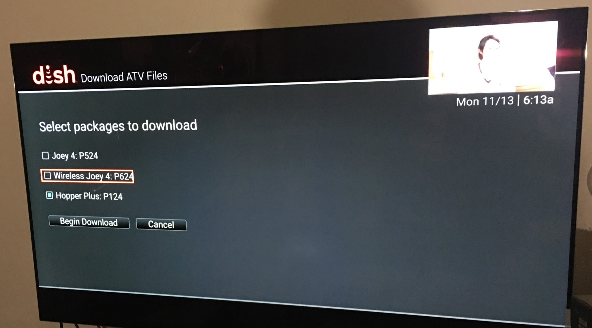

4) Download ATV files appears to be broken as I have noticed this with H365 and H366, it was working correctly a week ago on H365. Basically what happens is when I select "Download ATV Files", I get this:
4.1)
I select "Begin Download" and then get:
4.2)

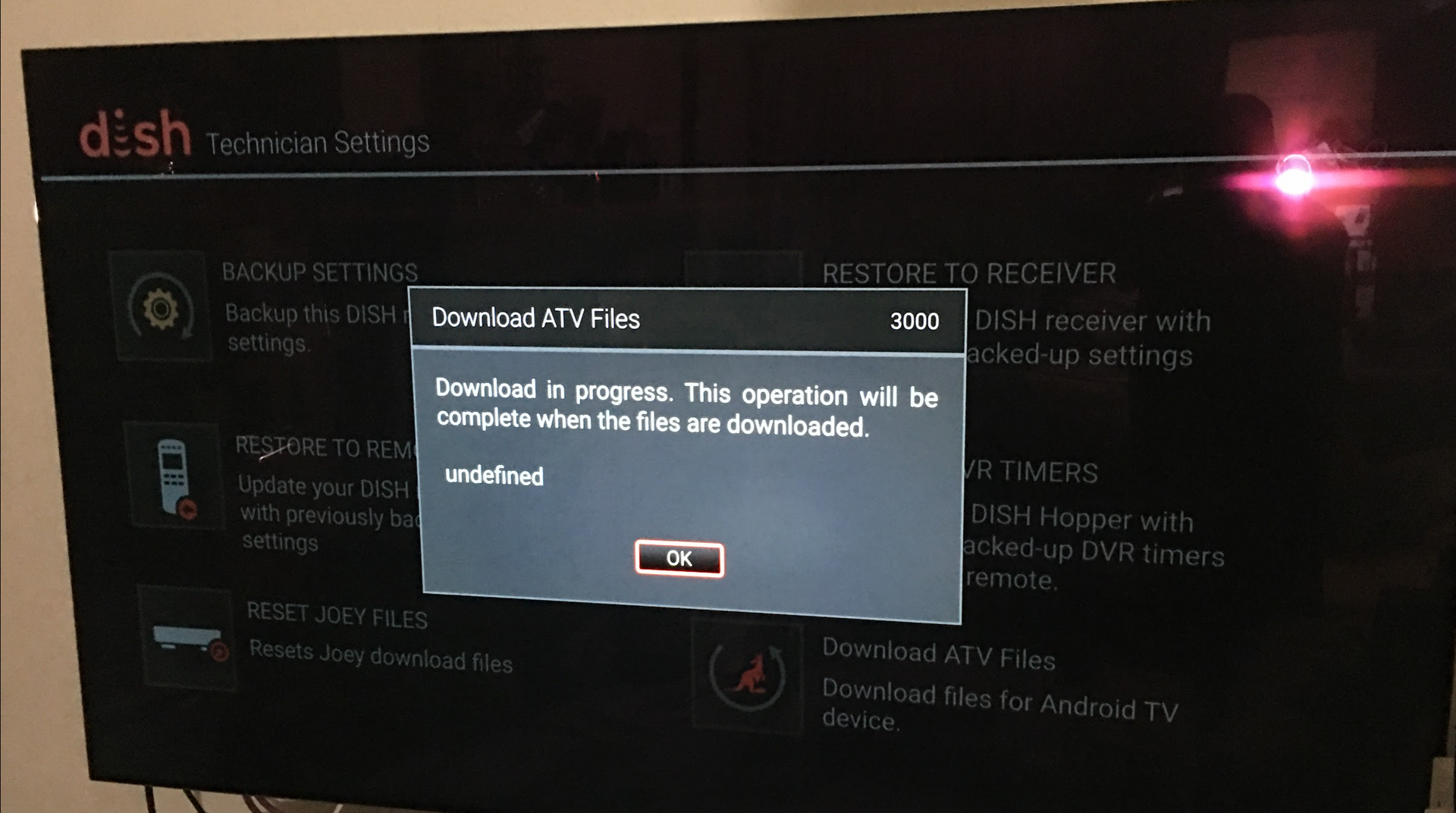

I press OK and then in 10 seconds, I select "Download ATV Files" and it shows:
4.3)
So at this point, the undefined appears to be an error and whether I check "Download ATV files" in 10 seconds or even a minute later, it basically goes back to the 4.1 screen and basically goes through the 4.1-4.3 sequence as it appears the above screen, the download process actually cancelled on it's own. There is no way to successfully download the ATV files as it will just go through the 4.1-4.3 sequence and one can repeat 4.1-4.3 numerous times after reaching 4.3.

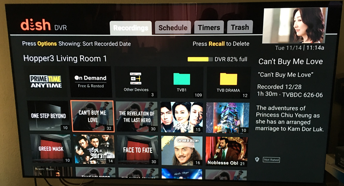

This is probably easier to explain with photos, when I hit the DVR button, let's use "CAN'T BUY ME LOVE" which is something with the problem currently as I saw this with other episode folders as well before, as you can see, it has 32 episodes:

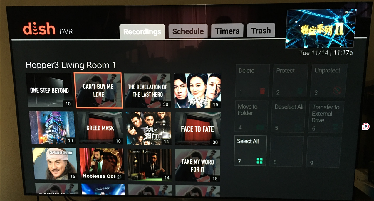

If I press Options and then Manage Recordings, notice the box with the number of episodes disappears while the other recordings do not have the problem.
So it seems I can move the recording to different folders without issues but just can't select it to transfer because the Hopper 3 is not seeing the # of episodes for that title with multiple episodes as it will show 0 episodes when selected. If I first went into the folder by selecting it so it displays each episode and then select Managed Recordings and then selected the individual or all recordings, then it would show the correct amount of recordings and the transfer would work.
