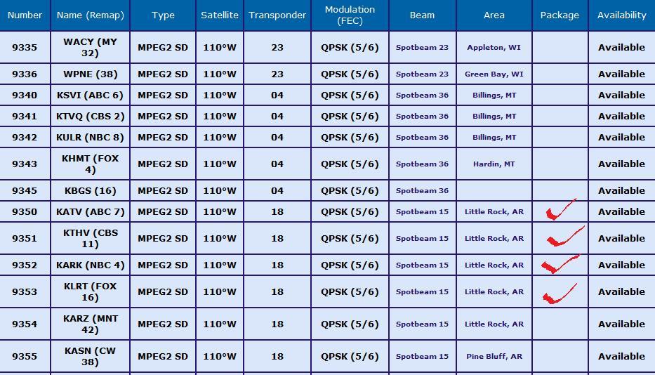

I upgraded a few days ago and got an 722k and 612 receiver. The Little Rock Arkansas locals that are available in HD(CBS, Fox, NBC, and ABC) come through in HD, but the SD channel isn't showing up on the Guide at all. The locals that don't offer HD, for example CW, do show up fine. I spent about an hour on the phone last night with Dish CS trying to figure this out, did check switch, reboot, etc but still no SD. My phone ended up going dead while everything was rebooting so my call with the rep got cut off. I got the feeling he was running out of ideas.
The reason I want the SD is because of the DVR space, as most of the shows we record are on the 4 major networks. Anybody had this issue or have any suggestions as what to do? From what i can tell all locals are broadcast on the 77 satellite.

ON eastern arc installs with the 1000.4 sat dish you will NOT get sd versions of your local channels if there are HD versions. You will get the lesser sd channels, like Cw in sd if that is all you have . Eastern arc doesn't duplicate sd channels if Hd channel versions are available.
they left the big 4 on 110, so you will likely need another dish pointed at 110 to get them all. then you will need to set timers on those channels in the 9000 range.
