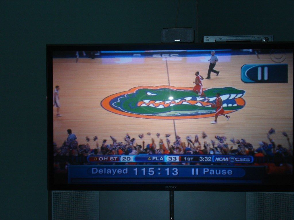

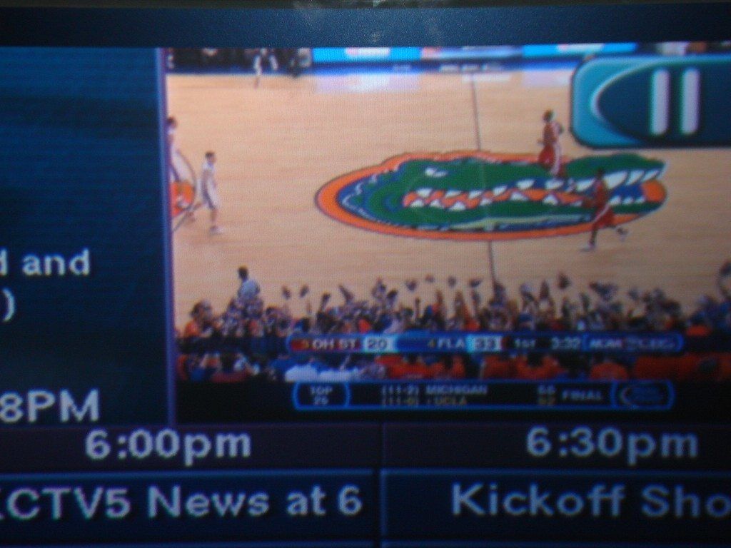

I have a 921 receiver and have noticed that the picture seems to be cropped a little.
The guide preview window displays the full image but when viewing in the full screen mode, the image seems to be cropped.
(see the left side of the attached pic.)
You can see the first picture has one basketball player on the left edge of the screen(full screen), but the second picture has two (the guide preview window).
Has anyone else noticed this?

Mezab,
Which mode is the receiver in. The Format button at the bottom on the remote allows users to select several modes, Normal, Stretch, Partial Zoom, and several others. Check to see if you are selected the Partial Zoom option. When viewing a 16x9 HD channel your receiver should be in Normal mode.
John
It is in Normal mode. I am connecting with a DVI cable to a Sony TV.
If you compare both images it looks like I am losing about 1.5" (from a 65" TV)from all four sides of the TV. Very minimal but a little annoying to know that I am missing some of the picture.
I am beginning to think it is just the way the Sony projection TV works. I already checked and there is no setting on the TV correct this.
Any other Sony people seeing this minimal cropping issue?
When you are viewing the small preview you are seeing the entire image (at least on the left and bottom), no overscan, but when you actually watch the channel your TV's overscan is cropping the picture slightly. Depending on your TV there may be a no-overscan mode or it can be adjusted out in the service menu.

I've had several Sony HD RP sets and all have overscan to some degree. I'm told that almost all TVs have overscan by design. Sometimes (particularly for SD channels) there is information in the top/bottom of the image that you aren't meant to see.
My current TV is a Sony SXRD 70". The overscan is about 2%, as measured by the ISF calibrator that I had adjust it. I believe that Dish HD DVRs also induce more overscan themselves -- certainly the test pattern on HDnet shows more than 2% overscan. This was true for the 921, 942, and 622 (at least on my TVs).
My calibrator does not recommend trying to fix RP overscan using the service menu. The overscan is optically done and changing the service menu would be an electronic adjustment. You would lose 1:1 pixel mapping in the process.
Yep that is it. The overscan. Thanks everyone!
This is not intended to be adjusted by a user. But I found a website (http://www.keohi.com/keohihdtv/) that tells you how to access the service menu. There you can adjust the vertical & horizontal picture size.
I adjusted the overscan a little, but adjusting too much caused some fuzzyness on the edge of the picture.
