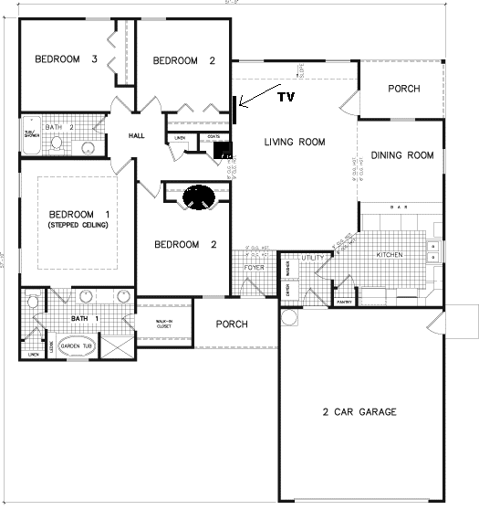

Just for background I am buying this LG 42 in. Plasma Integrated HDTV - Model 42PC5D at Sears.com I know it may not be the best but it fits what I want with my budget.
Below is a floorplan for my house. I have marked were I am mounting the unit to the wall. The circle is were I would like to put my receiver, dvd player, etc. but I would have to run a 25 foot HDMI cable if I were to do this. I have not done very much searching, but the cheapest 25 foot HDMI cable I have found is $125 Rocketfish™ - 25' In-Wall HDMI Cable - RF-G1157
You may ask why I don't put the equipment in the closet with the square, because I have already put my security system, and all of my home distribution panels in the other closet "plus its bigger". The other one directly behind is my sons. I am also working up to a home automation system so I want everything located in the same place.
So my ultimate question is while I can run a wad of coax cables for around 30 bucks, should I just bit the bullet and do HDMI?

Well there is my answer. Thank you sir.
Just a note to concur with haertig. I needed a 35-ft HDMI cable to run from my satellite box in the living room to my new HDTV in the bedroom. I spent less than $45 including shipping for a 35-ft HDMI cable with gold plated connectors from Monoprice.com.
John
Yep, Monoprice is great. I have bought literally dozens of cables for myself and friends/family, everyone is always amazed at the prices and quality. You will not be disappointed, they are great!
Another happy monoprice.com customer here!:) A 20' heavy duty HDMI cable was $15.xx plus shipping. I've used 'em 3 times and very satisfied. Great prices and fast shipping!:up
Ed
You'll save even more if you (can) run component. I am getting ready for a second HD set and need to span 55+'. Much cheaper, about 1/2.
