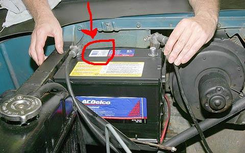

Well GM replacement batteries haven't used and "EYE" indicator in a long time. Also if your battery doesn't have a bar code label on the top which is where the date code is then it isn't a replacement. I can almost say that 99% chance its the original. We have replaced TONS of batteries because they either leak or are just bad. We even replace them before they are even driven off the lot. Here in Florida the normal life span on a battery is about 2 years.
Edit: Here is a picture of a replacement battery. Not the same 78 series you have but give you an idea of what it would look like. The datecode /bar code is circled.

Tks thiggin2! The battery I have has only one label on it, on the top surface. There is no second "bar code" label, and no label on the side like you pictured. That one label does have a large barcode on it, but the numbers below the code are only 19101810. There is nothing that looks like a date code anywhere on that label. Everyone here is pretty much confirming that what I have is the original.
