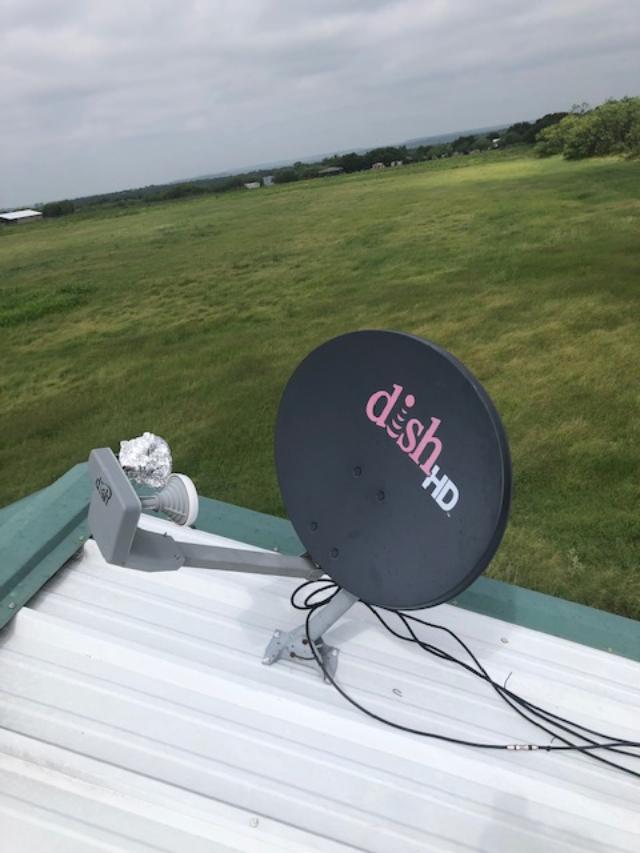

I have read through many post but can't find my exact answer sorry. I have Dish Network and a spare DishHD, with two LNBs I don't know if this is a 500 or 1000 or super maybe someone can tell me. I am trying to connect a 211K but cannot find a signal. I have read about covering one LNB up with foil, and try transponder 11 on Sat 119. I find a signal but then I get the error,"wrong satelite 72.7" or something like that. Any tips?

Can you post a picture of the dish and lnb you're using? And if you're looking for the 119 sat, and are picking up the 72, you need to swing your dish way to the right, to the southwest sky, not southeast.
OK finally had time to get back on this I have a VIP211K and this dish in the pic... Are they compatible?
thumbnail
Read through a bunch of post an I was desparate so I tried the foil, I took this dish of of one of my other properties almost exactly 150miles due west of here so I assumed all I had to do was rotate the dish a bit but then I saw a bunch of post about finding 119.... what is the model of my dish? 500 or 1000?
thanks a bunch
I can get 75% when I have the reciever on Sat 72 but I get error Wrong Sat EchoStar West 77. the dish is pointed slightly southeast

I assume he's asking about changing transponders on the check switch/point dish screen. That really makes no difference. I'm just wanting to know what sats he's actually currently pointed at, so I can direct him from there. When I'm pointing a dish with my meter, then yes, I do manually check different transponders.
