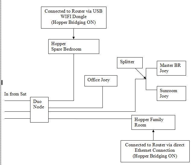

I recently had my Hopper/Joey system installed and wanted to make sure everything is wired and set up correctly. Please review the diagram and let me know if something looks out of sorts or if I need to change any settings (mainly bridging on or off)!
Thanks!

You don't need the hopper in the bedroom hooked up to the internet if you have the other hopper already hooked up to the net.
Other than that looks good to me.
Why do you use 2 internet connections? Only one connection is necessary if bridging in activated. Bridging on at internet connected Hopper, system should default to off at unconnected Hopper but check to be sure. Hardwiring is more stable.
Ok. I unplugged the WIFI dongle from the Hopper in the spare bedroom and left the Ethernet connection on the Hopper in the Family Room. I made sure the spare bedroom Hopper was connected using MOCA. Now that I am set up this way, do I need bridging turned on? I navigate to it in the menu and turn it on but when I go back in again to look it is turned off. I can't even get to the bridging option on the Family Room Hopper with a direct ethernet connection.
With all that said.....what is bridging for and under what scenario would you need it?
Thanks!

Do I have to do the above steps on both Hoppers? I have done these steps (minus the reboot) on the one in the family room that is connected to Ethernet and the bridging option never comes up.
Bridging allows the tuners to be shared... If you can view either hopper from one of the joeys you should be good to go. Yes after resetting both hoppers (roughly at the same time) then they should be able to talk to each other "share DVR content" regardless which hopper a show is recorded on you can watch it from any connected joey. If you have set up more then 3 recordings on one of the hoppers, from that hopper location or linked joeys on that hopper you cannot setup more recordings unless you do so from the other hopper/joey location but I'm sure that will change in good time via software update. Enjoy your new setup.
Rebooting I believe is a must. I did the bridging without and I still had reds. Rebooted and everything worked.
Reboot them both as close to the same time as you can, I not sure timing is critical though.
Bridging should only be enabled on the Ethernet-connected Hopper. Follow the steps previously mentioned on both Hoppers but make sure the unconnected Hopper has bridging off.
Sent from my iPhone 4S using SatelliteGuys
Thanks for all of the help! I now have Bridging on the Spare Bedroom Hopper turned off and no longer connected to the internet via wifi dongle. I have Bridging enabled on the Family Room Hopper that is connected to Ethernet. Before I was unable to get the bridging option to show up with two presses of the blue button. However, the menu at the top was set to "Top Ethernet." As soon as I switched it to "MoCa" I was able to make bridging appear!
Thanks again!
