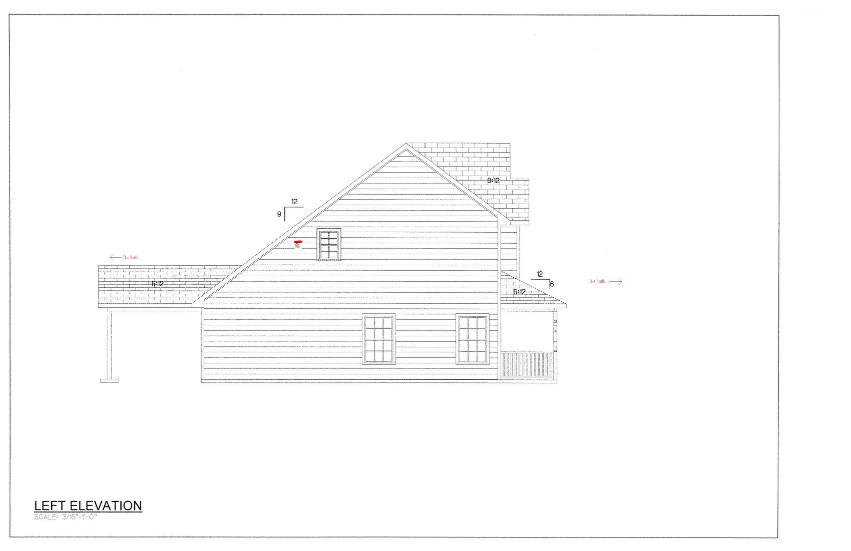

I am preparing to have E* installed in a new two story construction and have a few questions regarding prep for the install. Here are some of the particulars. This house faces due South (the back of the house faces due North). In the illustration attached, you are looking at the East side of the house.
I have marked on the side of the house with a red area approximately where I have ran 6-RG6 cables for the SAT, OTA, etc. Now these cables are at the exterior wall in the attic but not through the wall yet. They run from the wall to a central panel centrally located inside the attic. I would like the cable from the SAT to terminate at this panel and then distribute to four locations. Each location has two RG6 Cables already run. One for SAT the other for OTA.

2.) What would you recommend as far as mounting the Dish? Rooftop is not an option. I initially planned on mounting the dish on a pole which would extend up to the heighth of the cables as marked on the illustration. My concern is whether or not the front (South) of the house would have an impact on reception/aiming. If the dish will aim slightly East then I would think I would be fine? (I am in North Texas 75020 (Sherman, Denison area).

From Denison 75020 your satellites are to the South West so your cables are on the wrong side of the attic. IF pole or wall mounted where you put your cables the building will block your view. The West side of the house would be the probable location as long as roof mounting is not possible. The DNSC installers should be out of Durant so let them advixe you. Are you sure about your directions, IF NORTH is as drawn the red is on the WEST side not the EAST as you stated.
You are absolutely correct. The illustration shows the West side of the house, not the East and the cables are on the West side of the attic. Sorry for the confusion.

Order a CommDeck mount and have your roofer install it on the roof. You want to have it at a point where as much of the entire Clarke Belt is as visible as possible. You might not always have DISH and therefore you should consider the future need for seeing satellites all the way East and all the way West. Try to also have the dish at a lower point and near to the edge on the roof as some service techs are wary of getting on to steep pitches as well as working at height.
Also, have a ground wire available at the dish wiring point. At least a #10 copper wire that is properly bonded to your house power grounding system. If you're in a lightning-prone area, consider a larger guage of ground wire to help drain off even more static from the dish. Have your electrician also put a ground bus bar in the central wiring panel using a #10 copper wire.
