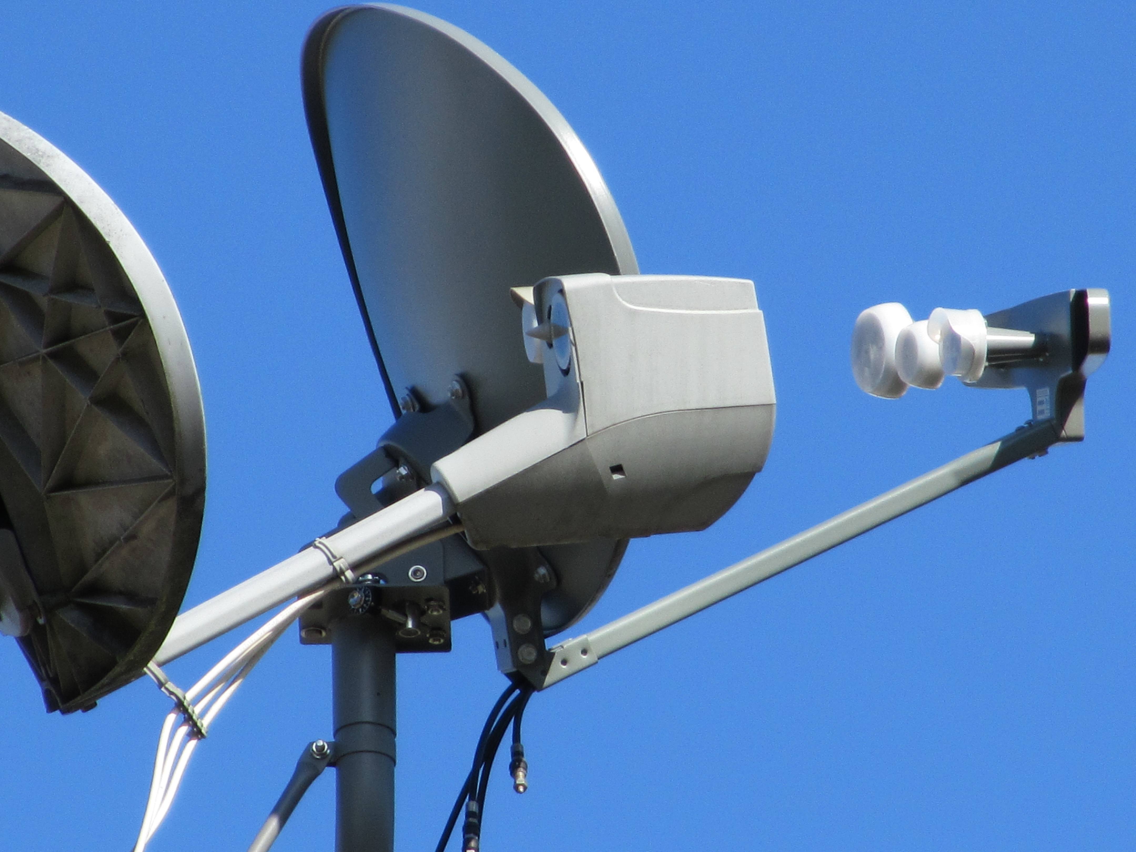

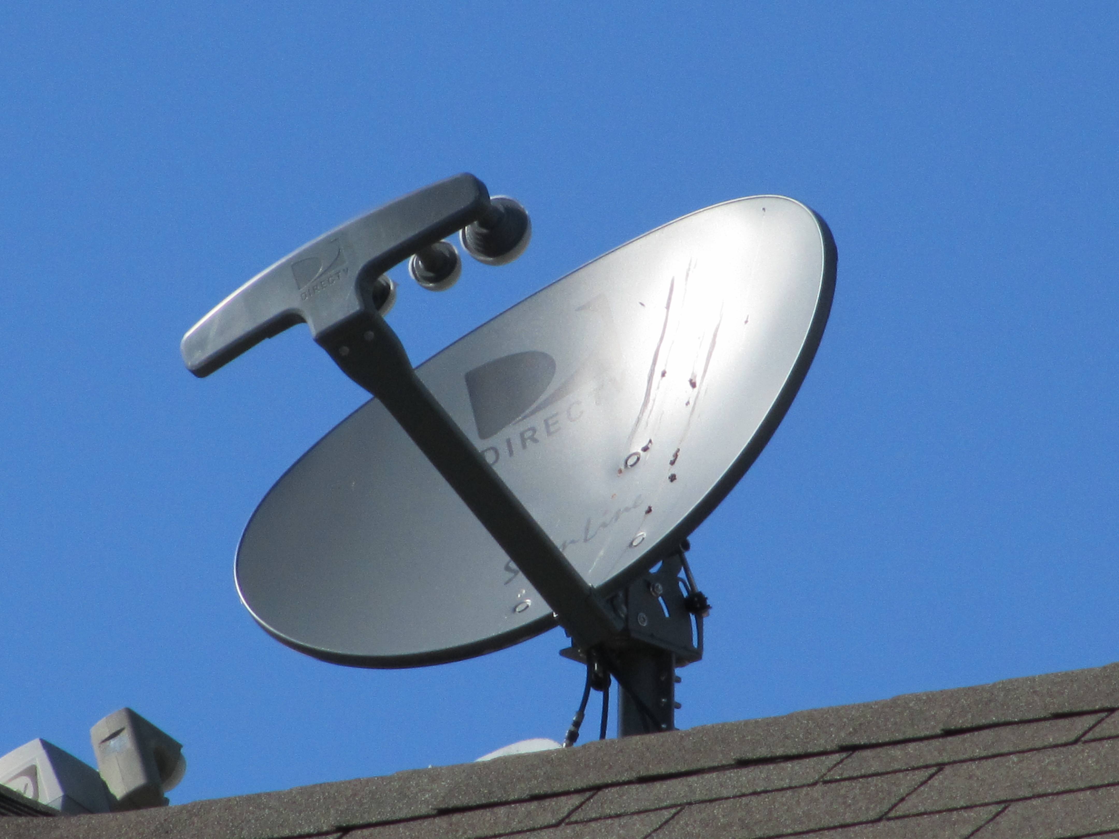

I have a Direct TV Slimline-5 dish on my roof with .jpg pictures attached to this thread.
*Note* When viewing my pictures please ignore the adjacent "Dish Network" satellite dish on the roof with 3 white wires attached to it as it is not in use.
I do not know the exact model of my Slimline-5 dish and weather or not it includes the SWM technology already built into it.

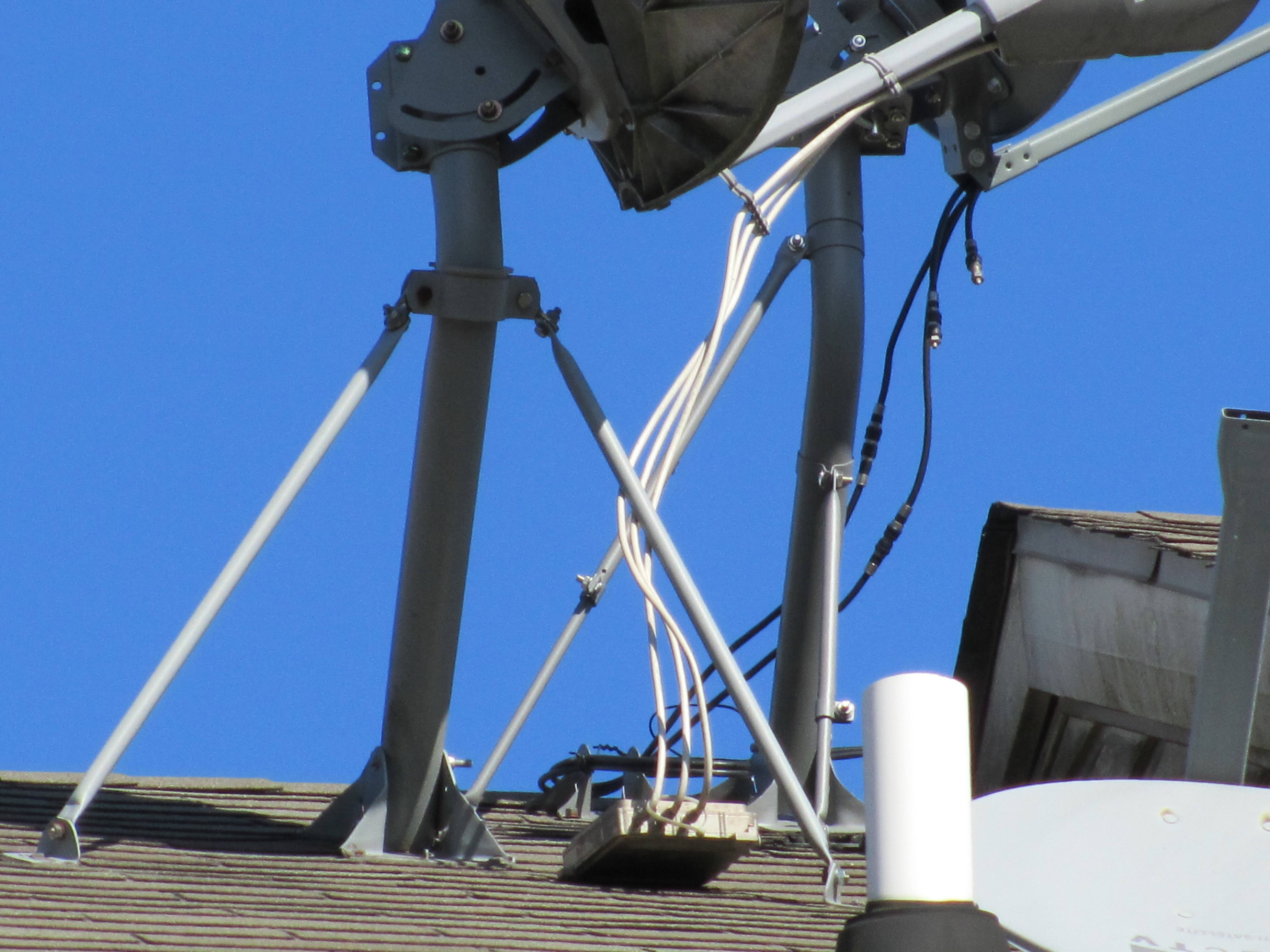

In the photo you can see 2 connected black RG6 coax cables coming from the Slimline-5 LNB.
Each of these connected wires makes their way into the house to different rooms for connecting my current equipment consisting of 2 HD receivers (H21-200 & H23-600). This set-up works fine and was configured by a Direct TV installer.

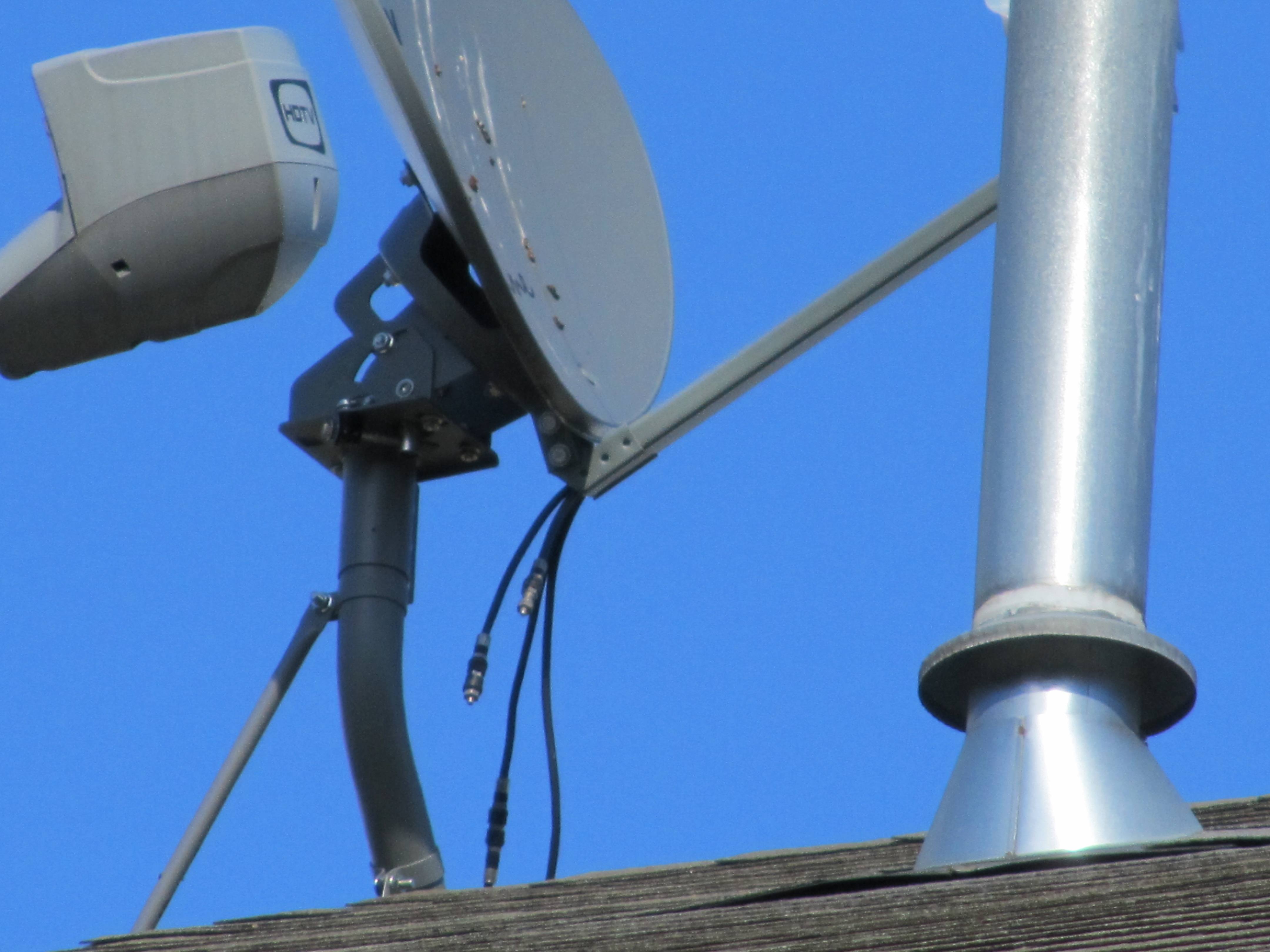

As you can also see in the picture are the other 2 RG6 coax cables coming out from the Slimline-5 LNB. These 2 wires are capped and dangling right there in the picture.

Based on what you've shown us, your dish has a legacy LNB which requires a run direct to each tuner. The installers, should you choose to use them, may replace the LNB with a SWiM LNB to simplify their job.

Basically, you SHOULD have 4 lines coming down from the Slimline dish to a ground block already, then you may not have needed to go up there.
You could have rewired everything with the current Slimline set up and been good to go.
To add another receiver you have to have it connected to the dish. In your case the dangling lines would have to be used. Thus a need to go on the roof. You could connect the SWM8 to the four lines and then have one line going into the house. But this would also require a trip to the roof. Or the SWM LNb could be swapped for the legacy LNB, but here again a trip to the roof is required.
