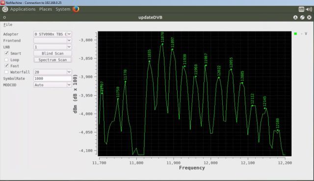

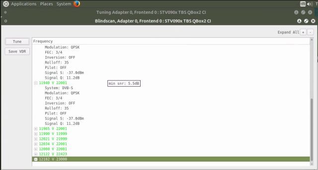

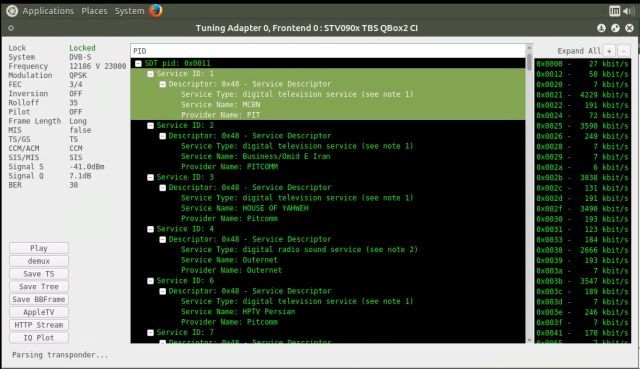

Basically reboot or plug in your DVB device, fire up updateDVB. Go to file - settings and configure your lnb. Save and close that dialogue. Then do a direction l spectrum scan, click on a tp you want to tune. A tuning dialog will open up, it'll parse the tp. From there you can do what you wish with it, play, steam etc

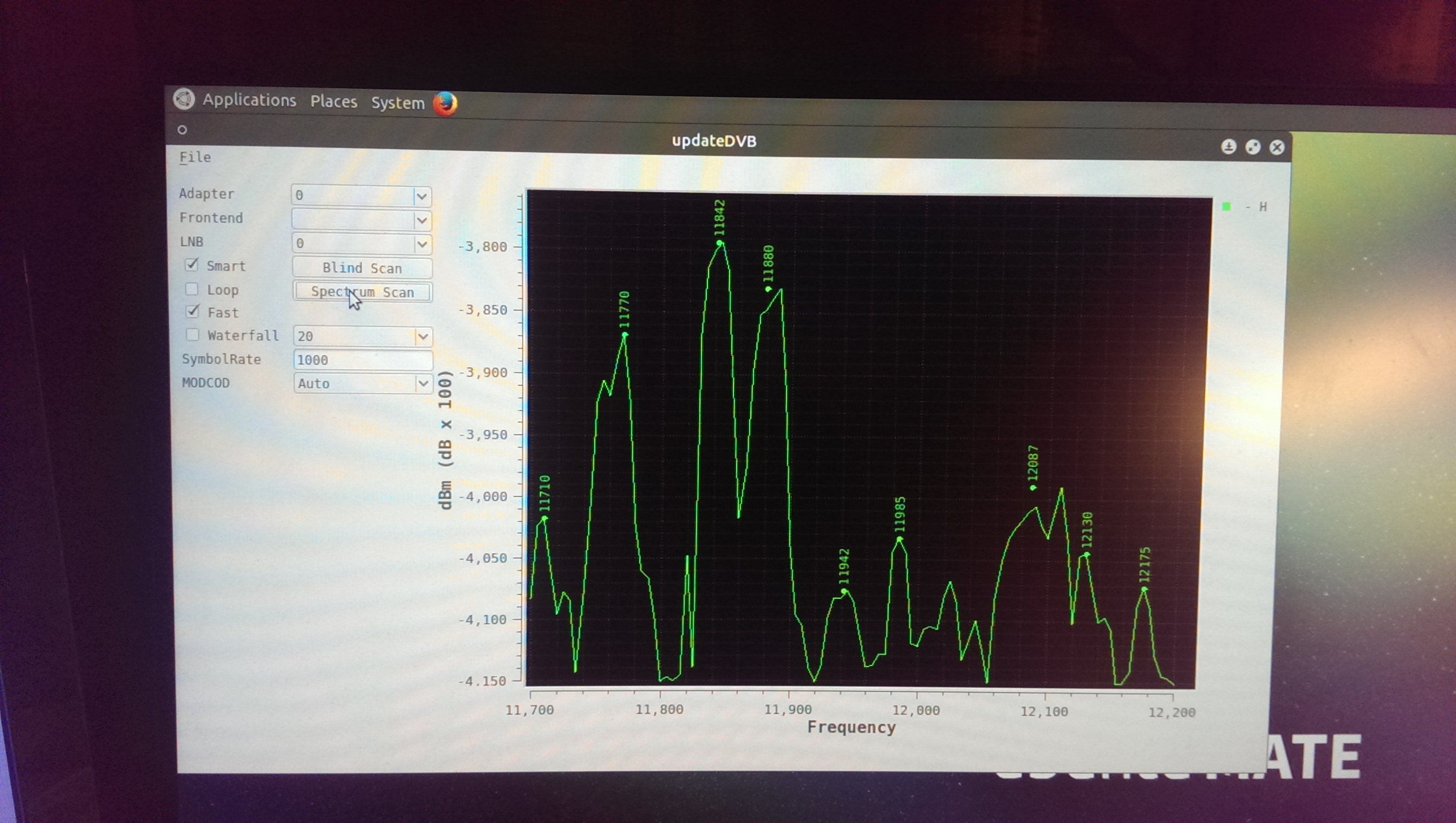

I think I have found the magic settings?
Reactions: Titanium
Its doing something!
