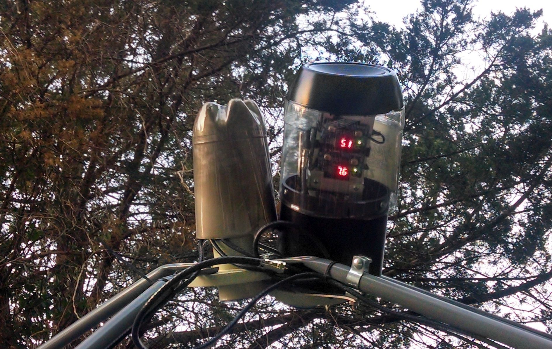

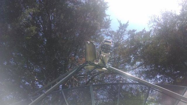

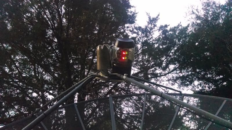

I am back up and running. I used a much shorter run for the Power over coax setup, about 10ft vs 70 ft.
It is working fine. The sun is in the wrong place for proper pictures, but I will get some more at dusk to show the display.
I have been remoted into it all morning via it's wifi link with no issues. Been trying to use alternate tuning methods.
