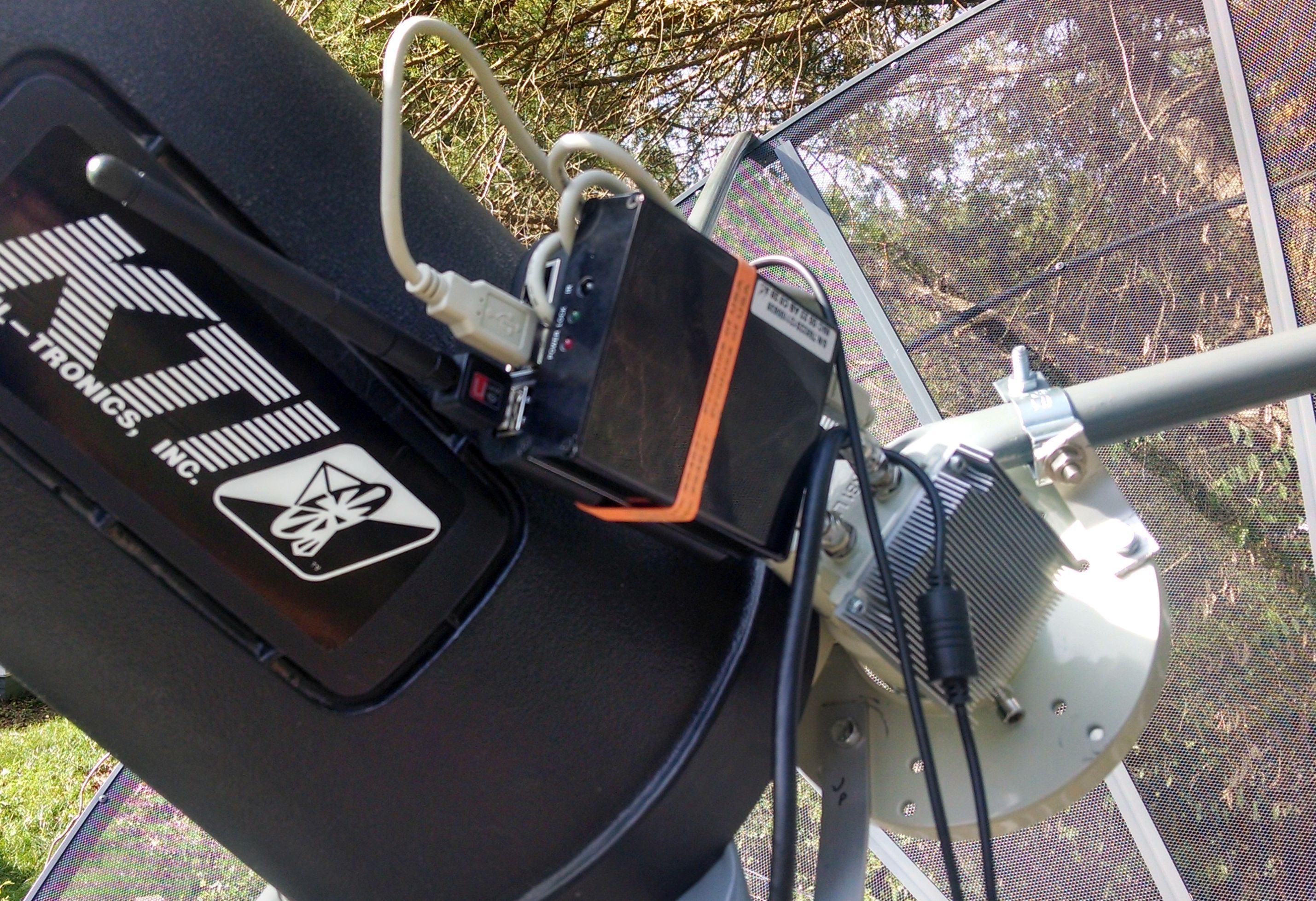

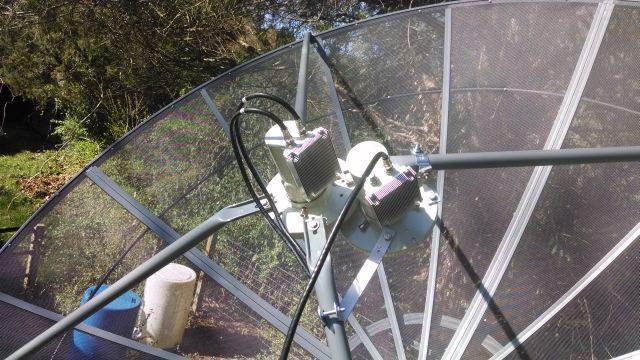

I installed a second C2pll on my 101W dish. Its pointed to 105W Nasa and will probably be where a do a direct attach of a Wifi Pi/Tuner combo:
I will probably cover the gear with a small feedhorn cover and have the antenna sticking straight up

Well the Spacex mission was scrubbed today, I was hoping to stream it over the dish mounted Pi. Just as well I think the DVB API on the image is too old to get some S2 channels. Could not tune in NASA. I will be doing some updating. I did manage to get my assembly out to the dish and comms over the wifi link were excellent.
