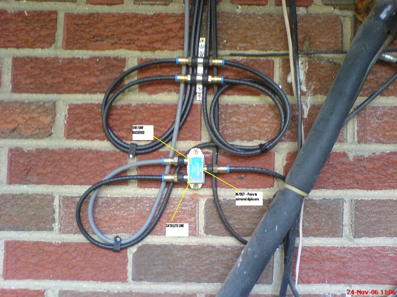

I am getting the HomeZone installed this friday. I plan on using the coax-output to backfeed into other TV's in my house. I know it comes with a splitter thing so that I can combine the 2 lines from the dish into 1, run it through my house, and split it back out. But to back feed for the other TV's, do I need another line of coax?
I have 1 rg6 cable running from the attic to the TV in the living room, I only want to have 1 wire total running through the house (too much work to run another). I was thinking of putting a splitter on both ends and trying to combine the coax output signal from the homezone onto the same coax line, but i am not sure if it would even work, or if they would interfere....
Any ideas? Is this possible?
BTW, Love the site!
Thats what I was hoping, but the problem that I thought would happen is that the satellite signal is traveling the opposite direction than the broadcasted signal. Is there different ends to a diplexer? Like a combiner and a seperater??? Or are they the same...
Diplexers are just like two-way splitters/combiners pretty much. They can flow in different directions.
Attached is image of diplexer.
yup... i have the same config with my system at home...
well, a little different, as my OTA seems to cause fuzzy TV2 reception if sharing the same cable, but i have two lines going into my theater room, one just for OTA, the other diplexed for satellite into my HZR and to take TV2 back outside.
Outside I have another diplexor to split the incoming satellite signal and the TV2 cable that goes into the master bedroom.
don't forget the cool splitter trick to extend the reach of your TV2 radio remote (if needed). I needed to do it at my old house (master bedroom was across the house from TV room). Simply take a regular coax splitter and connect it to the TV2 output of your HZR and to the RF Antenna connection. then use another splitter where your TV2 cable comes into your 2nd room and connect one side of the splitter to your TV and connect the RF antenna to the 2nd output of the splitter.
