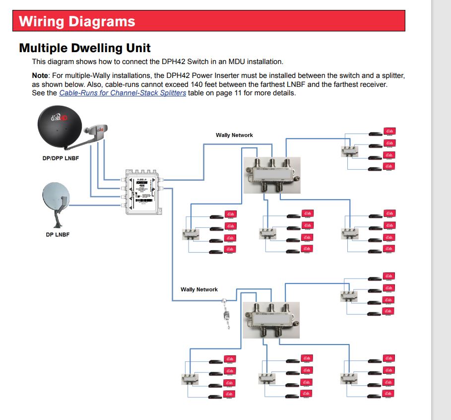

I have been reading and wonder if I also need a DPH42 Switch? And if so would I also need a power inserter?

Usually the switch is unnecessary, other members have had success using the DPH LNBF's. I will mention that the Out port labeled DC pass on the splitter needs to be the first one to be hooked up and always have a powered Wally attached, since it's the one that provides power to the LNB. Also, only one Wally can be setup at a time, so you shouldn't try connecting any additional Wally's until you have the primary working.
If these steps don't help, the next thing I would check is the distance or quality of the coax cable, I believe you can't have more then 200ft between LNB and each Wally.
