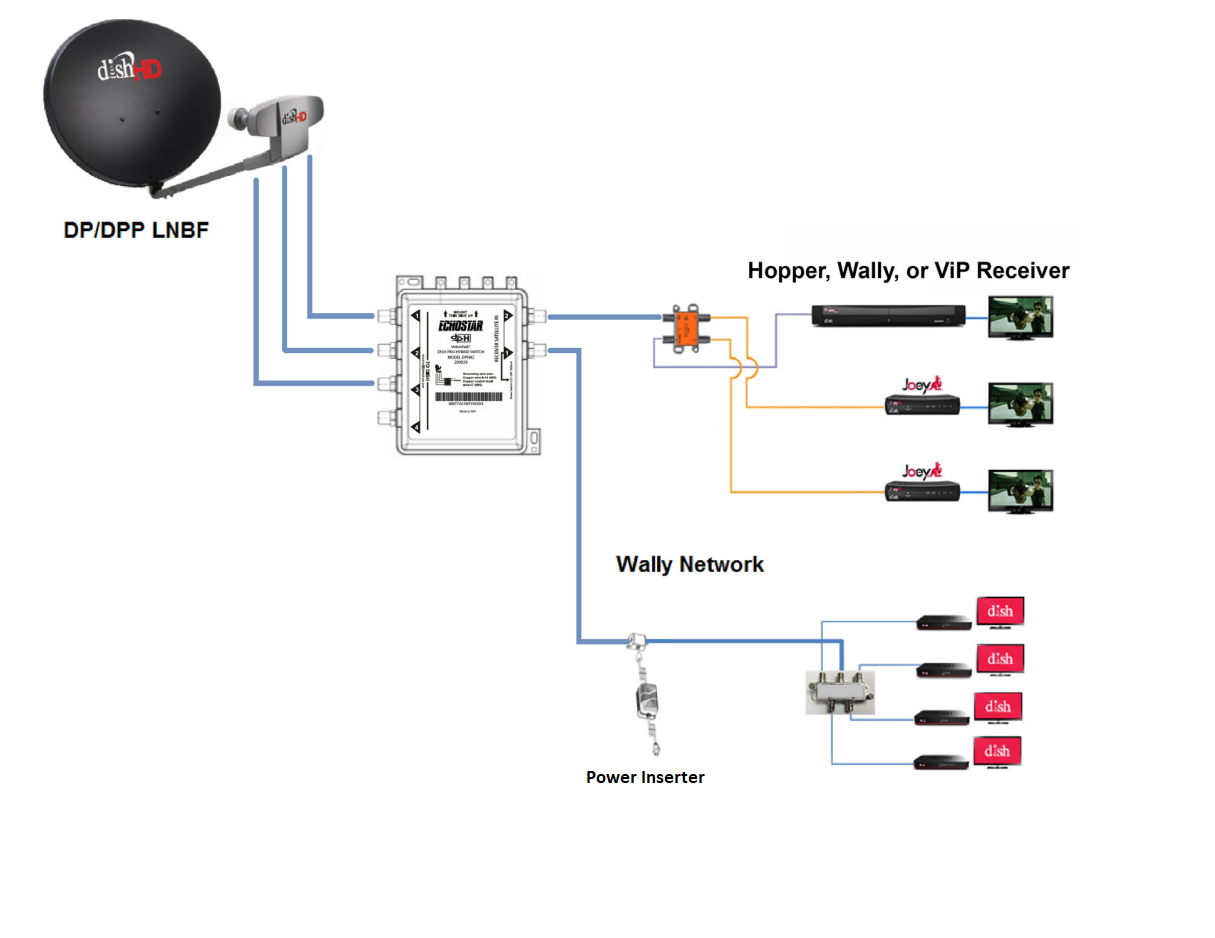

After much research I have figured out in order to run a Hopper 3 with 2 joeys and 2 Wallys there will need to be two different Dishes or a DPP LNB with a DP42 switch. Reason I'm wanting to do this is I have an RV with 2 wallys. I want to use the two wallys to move back and fourth from house and RV. The dish on the house will be a new install with all new equipment (currently the home is under construction). I figure the easiest thing is install one Dish with a DPP LNB and DP42 switch. Question is would the installer from dish (when I call them to install) install a DPP LNB if I asked for it. Or will they automatically install the hybrid? I will have 4 RG6 running from dish location into the attic where home runs from each tv location run. I have no problem buying the DPP LNB and switch and changing it out once the installer leaves. If this is what I will need to do which LNB would be the correct one I need bi see several different models online. Will the dish need to be re tuned if I have to swap the LNB's myself?
I think that DPH42 switch has only 2 outputs, leaving one of your Wally's out in the RV.
Here is the DPH42 manual. https://manuals.solidsignal.com/DPH42_Installation.pdf
You are going to need one of those switches, and something called a channel stack splitter. Here is one from SolidSignal DISH 2-Way Stackable Commercial Splitter for DPH42 Switch (ES009714) , if you get the switch from there, I would highly recommend buying both in the same order because they charge UPS ground shipping regardless of how small of an item you buy (It would cost me $16 to have that $7 splitter ship to Texas for example).
I think that DP42 switch has only 2 outputs, leaving one of your Wally's out in the RV.
One of the outputs (or even both I believe) can be split off with one of the previously mentioned splitters up to 16 times, both Wally's and Hopper Duo's support this. (That's the reason they are considered Hybrid receivers despite only having 2 tuners).
The DPH42 is for use with the Hopper Joey configuration using a standard DP LNB. The Wally's would be fed directly from the dish in front of that 42 switch.
Do you mean connect the Wally's on the same LNB as the switch? That would not work, you need one coax run per satellite to get the switch working (Just like with the DPP44) so all of the LNB outputs would be taken up by the sat feeds. Only exception to this might be the DPP EA Twin LNB, it has 3 outputs but only two would be used for the switch. But there is a high chance the LNB will disable its internal switch when it detects the DPH42, in which case port 3 would provide sat 72.7 only.

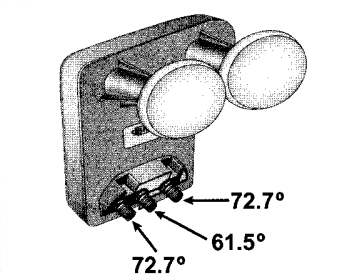

Thanks for the drawing and Info. This is exactly what I figured I had to do. Do you know if the Dish Installer will install this way? I am guessing they will not which is no big deal as I can do it. However, I notice several different DPP LNB. Is there one that will work with the actual Dish that the installer will install? Only reason I am even wanting the installer is so I do not have to install and tune the Dish. If I am going to have to retune or change the dish out there is no reason for them to even come out. If I go this route with a DPP LNB will I lose any of the options the Hopper 3 offers?

I am in Florida so going to need a WA. From what I have gathered I will need an LNBF Bracket to install the DPP on to the 1000.2 dish. The part I am having troubles figuring out exactly what I need is the actual LNB. I see the DPP 500+ receives signal from the 110°, 118.7°, 119° and 129° orbital locations with the additional bracket and LNBF. However, what is the additional bracket and LNBF. I can not seem to find that anywhere. Is this what I would actually need or is there a better option to get all of the signals?
Unless you are intending to get international channels excluding the already existing Spanish channels on the regular satellites, you do not need the DPP 500+/1000+, since this LNB belongs to a dish named the Dish 1000+ for reception of the international satellite at 118.7. If you are indeed getting international channels, then you don't need to worry about anything because there is only a DPP version of the 1000+ and you will have a DPH42 installed anyway to feed the Hopper 3. But I suspect this is not the case, right?
Here is an example on eBay of what you need (given the nature of eBay, I'll mention that I'm not endorsing these particular sellers, it's just to give you an example. I've yet to have a problem buying used LNBFs off the website but you never know with used stuff).
WA LNB : Dish Network Dish Pro Plus 1000.2 Triple LNB 110 119 129 HD | eBay
EA LNB: Dish Network LNB 1000.2 DPP Twin Eastern LNBF Pro Plus EA Arc 72 61.5 Satellite 753960012728 | eBay
Bracket (works for both): DISH NETWORK 1000.2 INTEGRATED LNB BRACKET / ADAPTER / HOLDER / YOKE BRAND NEW!! | eBay
