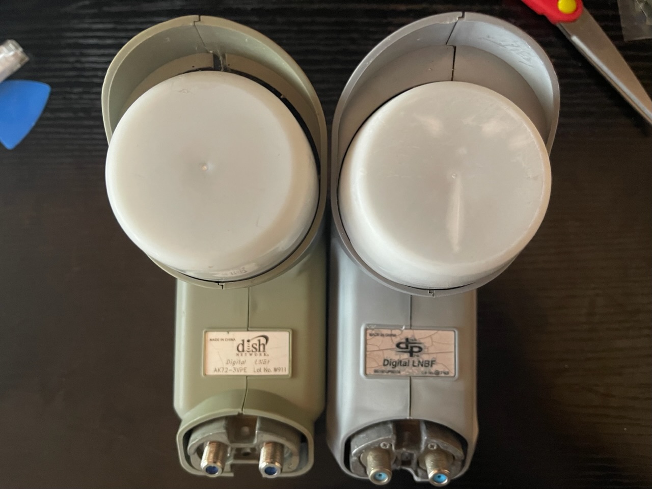

The LNB you need for 110 is NOT a legacy LNB. It has to be a DishPro single or double output. If you connect a legacy LNB to a 1000.2 you will only have access to half of the transponders from the satellite, as legacy uses voltage switching for even/odd transponders and DishPro uses stacking instead.
Attached below is a picture of the two LNB models, the one on the left is a Legacy and the one on the Right a DishPro (DP symbol on the sticker).
That's important to know. The one I have been using is the legacy but only interested in several channels so maybe ok on those transpondes. Anyway I actually do have a DishPro double output and will give it a try. Thanks!
