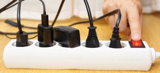

A typical surge protector uses a component called a metal oxide varistor (MOV). When the voltage spikes, the surge protector effectively diverts that extra voltage to the MOV component. This component degrades when it's exposed to either a small number of large surges or a larger number of smaller surges. The additional energy doesn't damage your devices — it stays in the surge protector, where it degrades the MOV.
In other words, your surge protector can only absorb so many surges before it stops functioning as a surge protector and starts functioning as a dumb power strip that'll let everything through to your devices.
