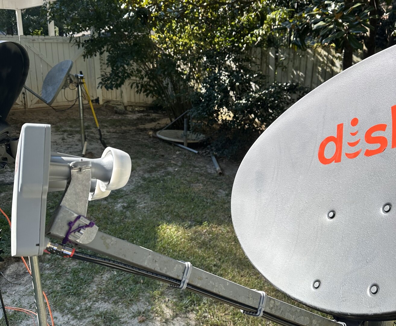

How the heck did you attach the new WA LNB to a Super Dish feed arm when it's designed to fit not just the way it attaches, but use the shorter length of the 500 Dish feed arm??

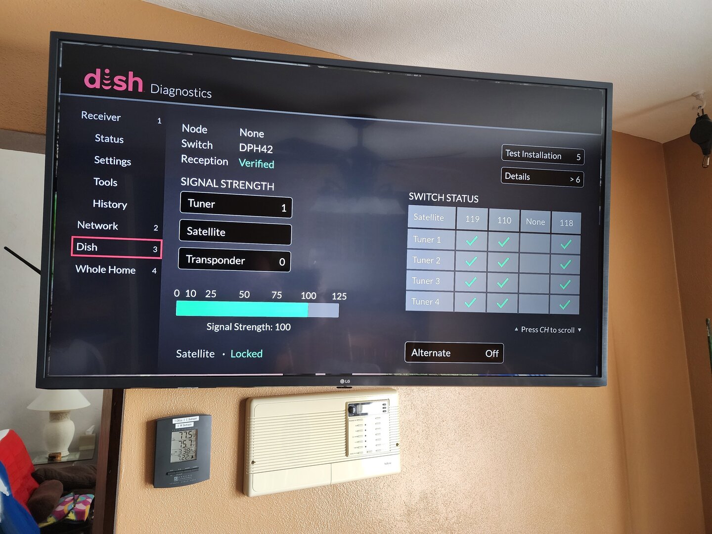

OK I think I know what it was, in the picture you posted, there is no satellite or transponder selected and the meter shows 100. I think this happens if you're watching an OTA channel when you launch into the diagnostic screen. As soon as you get it to populate both of those it gives accurate readings.

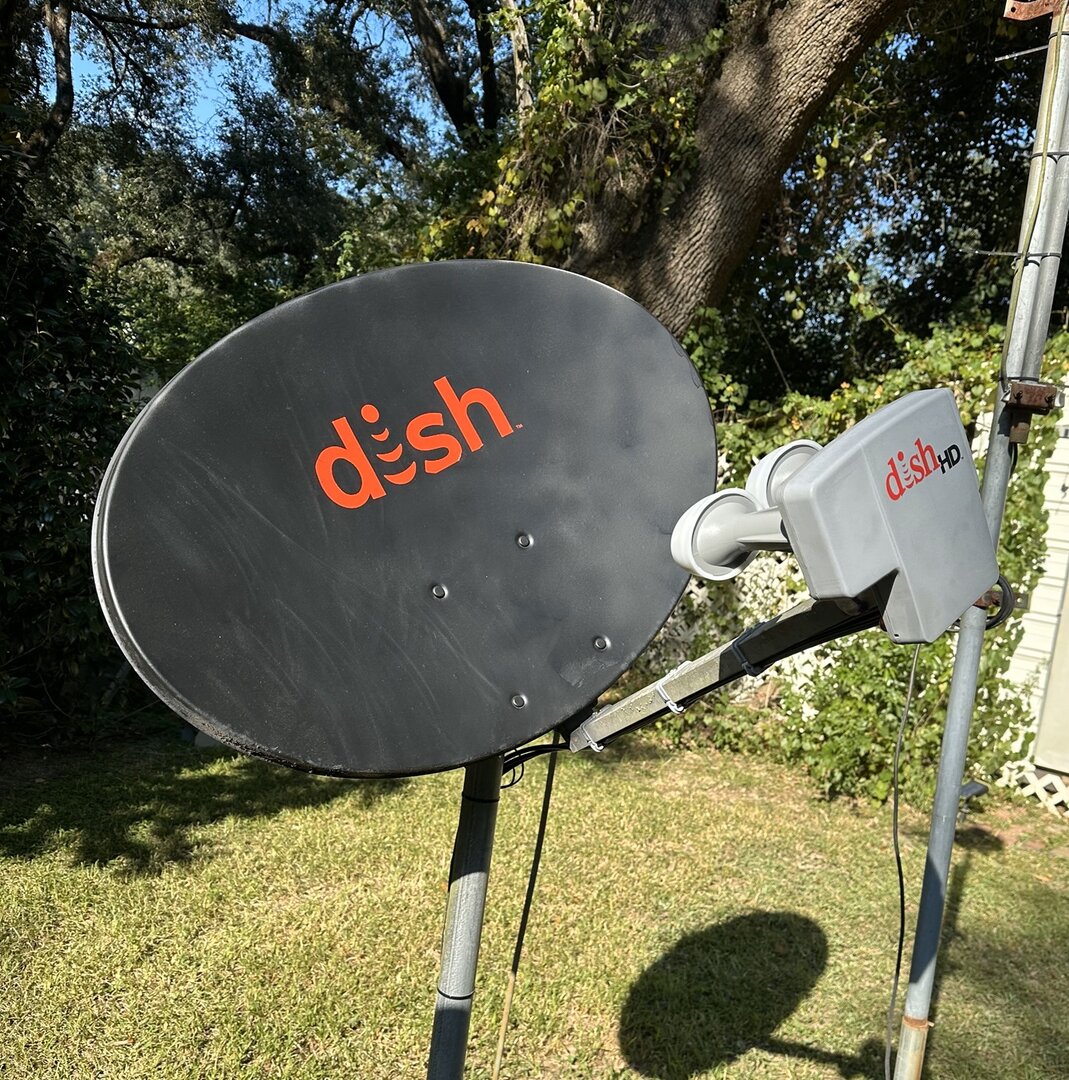

Here's an update on the project which I'm now calling complete.
The final configuration ended up being the one with the zip-ties. The D500+ LNB assembly I had turned out to be defective, ports 1 and 2 were fried. It worked fine with a Wally attached to port 3 but not the other ports. So I got a good one of those and the DPH42. Ports 1, 2 and 3 of the LNBF assembly to inputs 1, 2 and 3 on the DPH42, and the power inserter between the hopper and the cable going to output 1 of the DPH42. Wally to output 2 of DPH42. All is working well now and after tweaking the aim a little bit, about 10 points higher on the STB signal meters than when it was the DPH triple on the 1000.2.
Lastly, I decided to get creative. First I cleaned all the dust and bird droppings off the old badly faded superdish. I sprayed a new coat of paint, then found the new dish logo on their website, converted it to SVG and used the Brother Scan-n-Cut to make a marine vinyl sticker. If you look closely, the zip-ties are still there -- I have drilled a hole for more permanent mounting but need to find a proper sized bolt to fit.
I also took the opportunity to dig up all the old decrepit cabling and replace it, along with some new stuff for the FTA dishes which are finally getting some attention after a few years of me being too busy for anything but work. I had forgotten how much I enjoy tinkering with this stuff.
