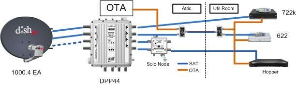

Would this layout work?
The hopper will be a on a separate account.
<img src="http://www.satelliteguys.us/attachment.php?attachmentid=83110"/>
Only if you have no tv2s on the 722 & 622. Dual tuner recievers dont play nice with diplexed OTAs. In fact, I'm hesitant to say it wouldn't cause issue even with tv1. Best option would be bringing OTA on seperate feed from the Dish system at least to the splitter.
I believe that will work just fine. Agreed with Aidan8et though on the TV2 thing but I'm pretty sure based on your diagram that you aren't feeding anything back out on those lines.

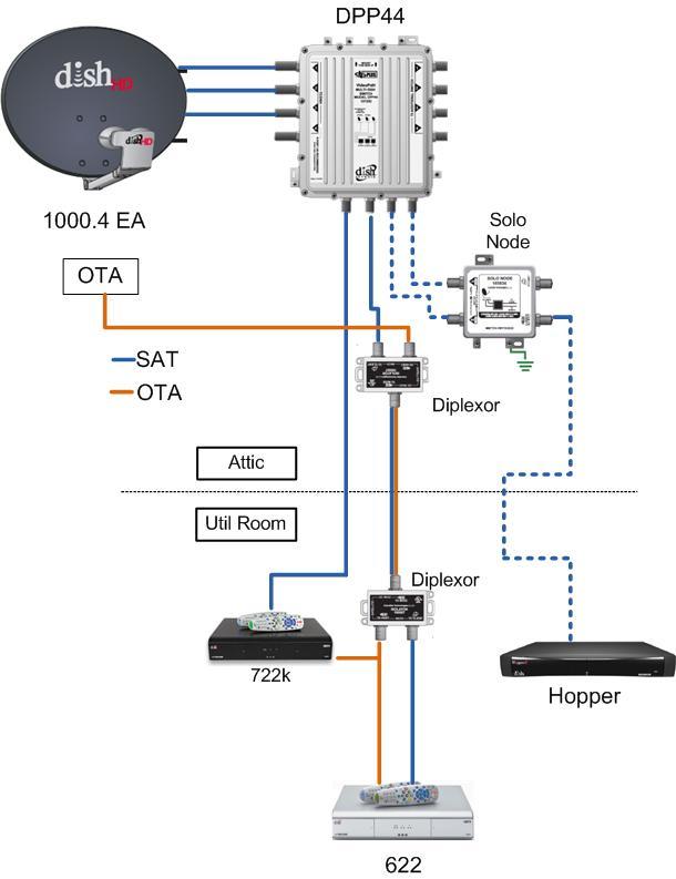

Ok. I re-wired my Sat network the other night to free up that third Coax from the Attic to the utility room for the Hopper. I currently have it wired up as follows and it is working with the 722k & 622.
The hopper will use the 3 & 4th ports on the DPP44. Let me know if everything looks feasible.
Thanks.
Looks to me like you are all set Cyclone. That's exactly how I'd wire it if I was doing an install with that configuration.
Oh, and very nice diagram!
Thank you. Its good to have a copy of Visio to make those diagrams. The first Diagram I made, I had Visio zoomed in at 200%. So When I published the jpg, the picture was much smaller than when I had been working on it. This time I made it a proper size. :D
The only drawback that I'm going to experirence is that I had used that third coax for strickly the OTA signal. That allowed me to use a powered signal amp on the OTA with that amp in the attic and the power inserter in the Utility room. Now that the OTA feed is diplexed, I can't use that powered amp. I don't have a power outlet in the attic (at this time :) ). I will have to explore my options because now that that amp is omitted, I have lost many of the Baltimore OTA channels that I once had.
